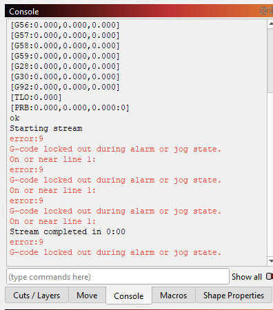

Thank you to both you and Dominic to responding. I had followed the instructions that you gave about the firmware not needing an upgrade and enabled the $21 and $22 settings in lightburn
but this is the message I get.
and the laser makes a grinding sound and freezes. A hard reboot, removing power and usb leads makes no difference.
One other point, if I select Go To Origin, the laser head goes from 0,0 diagonally right across the frame until it crashes into the top right edge !

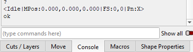

‘?’ result =
When using the move arrows, to move the head away, and then touching the Home icon, the head travels to the correct position on the X switch but stops approx 2cm away from the Y switch and sounds like a cog is grinding.
The screenshot shows that the x limit switch is activated. Is that true? Otherwise there might be an electrical issue. It should only show Pn:X when the x-switch is activated.

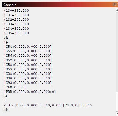

Move the laser until it is sitting on the limit switches and power it up. Clear the Console Window (right click) and enter these commands one at a time:
  1. $$
  2. $#
  3. ?
Copy everything in the Console window and paste it in a reply.

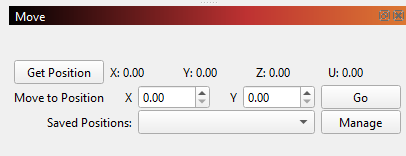

Edit: except one detail: once you homed, which position is shown in the move window?
Next, make sure that you have set the origin in device settings to bottom-left. Then everything should work fine in LB as well.

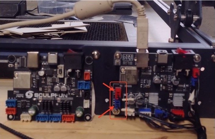

Good evening @patchworks I believe I may have had the same problem with S30 at one time when I had to change the board in it. The new board although appeared to be marked correctly as the old one and colored coded correctly it was actually reversed and I had to change the X and Y Axis cables and that solved my problem.
Picture Below:
Hope this works as it did for me I actually discovered while having it centered and homing at startup and manually hit one of the limit switches to see which axis actually stopped.
Dan

Thanks, I had considered that and swapped the leads over, but then nothing worked, so I put them back as per the motherboard markings :smiley:
The position at ‘Home’ is

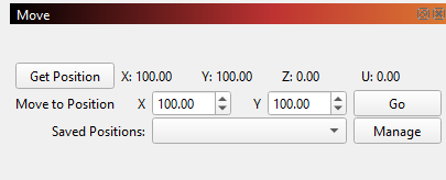

However, if I use the Move to Position and set it to 100x 100y. the head moves to that position and the Get Position shows
But, if I then click on the Home icon, the head goes to Y goes to Y0 but the X travels to X1 and doesn’t trip the switch and there is the grinding noise, that I mentioned, as the head tried to continue to the left and has to be stopped by turning the machine off by the power switch. Then I have to shut down Lightburn in order to clear any cache or it just freezes.
I know it sounds ridiculous and I know that the GRBL commands for Lightburn and LaserGRBL are the same BUT, in LaserGRBL if the head is moved and then Home is selected, the head goes back to 0,0 and stops. The only was to do this in Lightburn is to use the move tab and enter X0 and Y0 as the co-ordinates to go to and select Go and the head moves to that position and both switches are activated!

Here is the console with the switches both activated (manually)
