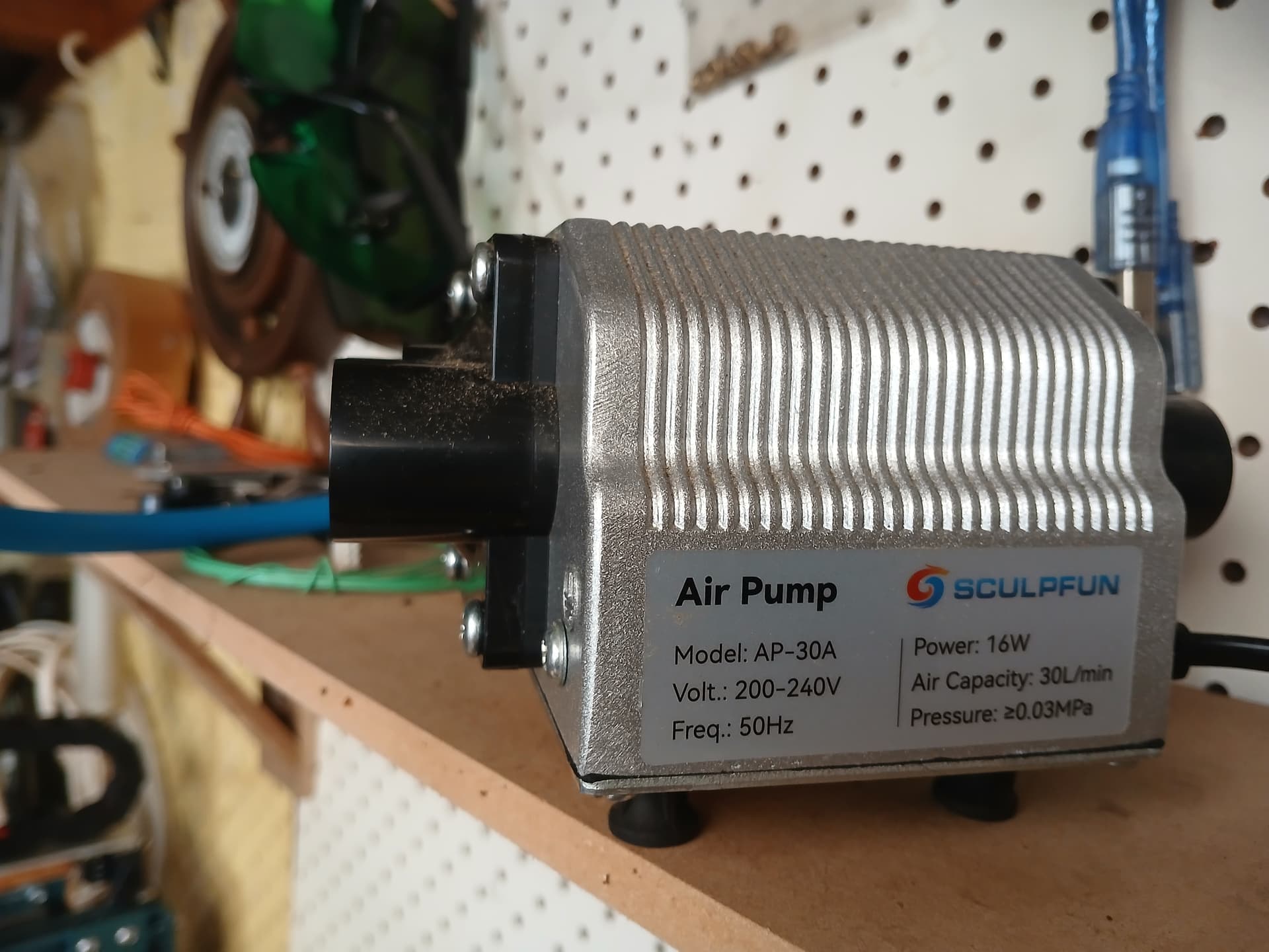

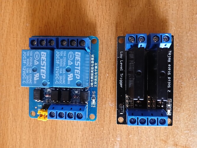

I post picture’s of my pump, and a couple relay’s I have, are these relay’s ok…
My problem is the wiring between the pump and relay the picture in your wiki looks like it comes from below the power plug but I did see somewhere that it can come from the pump itself…

The left relay can’t be used, it’s 12V. You need a 5V relay, that the board can drive. On the other one, it’s written on the side, I think.
Regarding circuitry, you wire the relay in the path of one of the wires. In your case, I’d select the blue one. Cut the wire and put both ends into the relay. The relay will then open and close this cable/connection then.

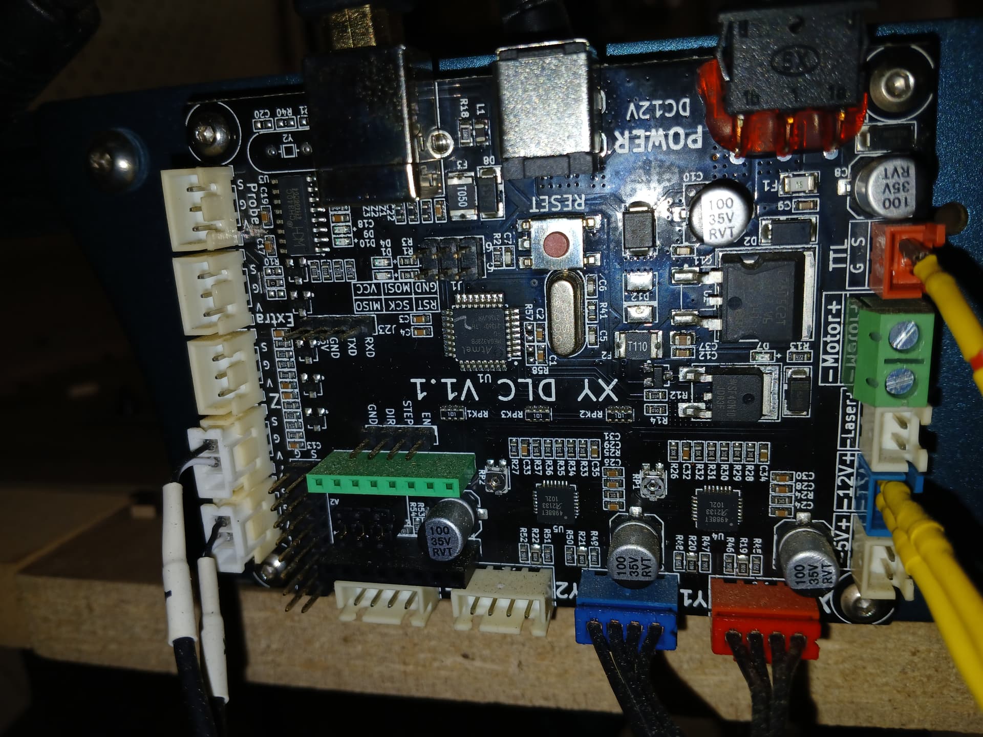

Just to clarify If I use the board I have (XY DLC V1.1) It has no Air Assist plug on it so I can’t use that one, or do I use the tha Relay the one on the right as picture above… or do I get (Sculpfun Motherboard | 32bit for S9/S10 /S30 series | Laser Engraving) do I still need a relay…

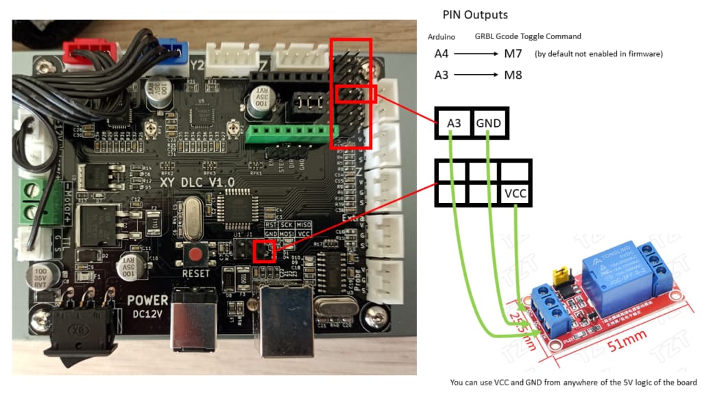

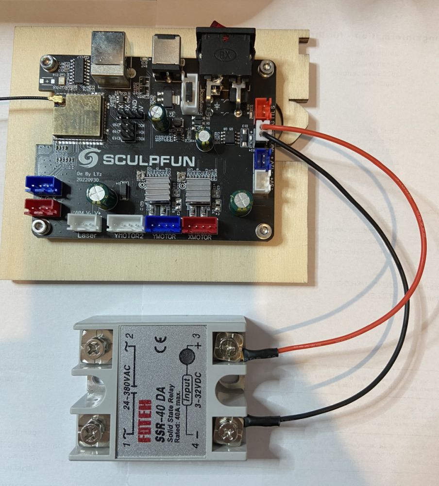

If you have a mainboard like this, you can use exactly this wiring scheme:
Yes, you do. The newer boards control the pump directly, not using a switch. If you have a mains powered pump, you need a relay in any case.
This would look like this:
Hello Melvin, just reporting that I have the pump and relay wired in, I did use the Blue as suggested but that did not work, as the Red wire is the live wire that did work, but some problems… When the Air Assist is set for off, the pump is on, when it switches to the next layer which is set for on the pump turns off…
I tried switching the A3 wire to CH1 but the pump just does not work at all…
So something is off somewhere, as per the lbrn2 diagram from above, the wires are attached as VCC to DC+…GRN to DC-…A3 to CH1…
As my mainboard is V1.1 but all looks the same as V1, but wood it make any difference which Ground pin I used…
Cheers Merlin…
Did you use the right (SSR) relay from your pictures above? This is then caused by the relay being “low-level active”, which is inverted to the air assist logic. You need a “high-level active” relay. This also holds for the other type of relay. For the blue relay type, you can use different contacts to invert those again, but this would turn the pump on every time the laser is turned off. So not a very good solution. Check if you have a high-level active relay somewhere.
Sorry Melvin I’m very confused now, can you point me in the right direction on where to purchase said Relay, I have attached the Mainboard I have and the only relay’s I have on hand are the ones above under the pump picture…
Sorry but I don’t know very much about electronics…

If you used the relay in your picture on the left, it looks like it can be configured either way.
I thought I could only use the 5v relay as the one on the left is 12v…

Your right it needs to be 5v. You need something like this which is 5v and can be configured to be on with a high or low input.
AEDIKO 4pcs DC 5V Relay Module 1 Channel Relay Switch Relay Board with Optocoupler Isolation Support High or Low Level Trigger: Amazon.com: Industrial & Scientific
