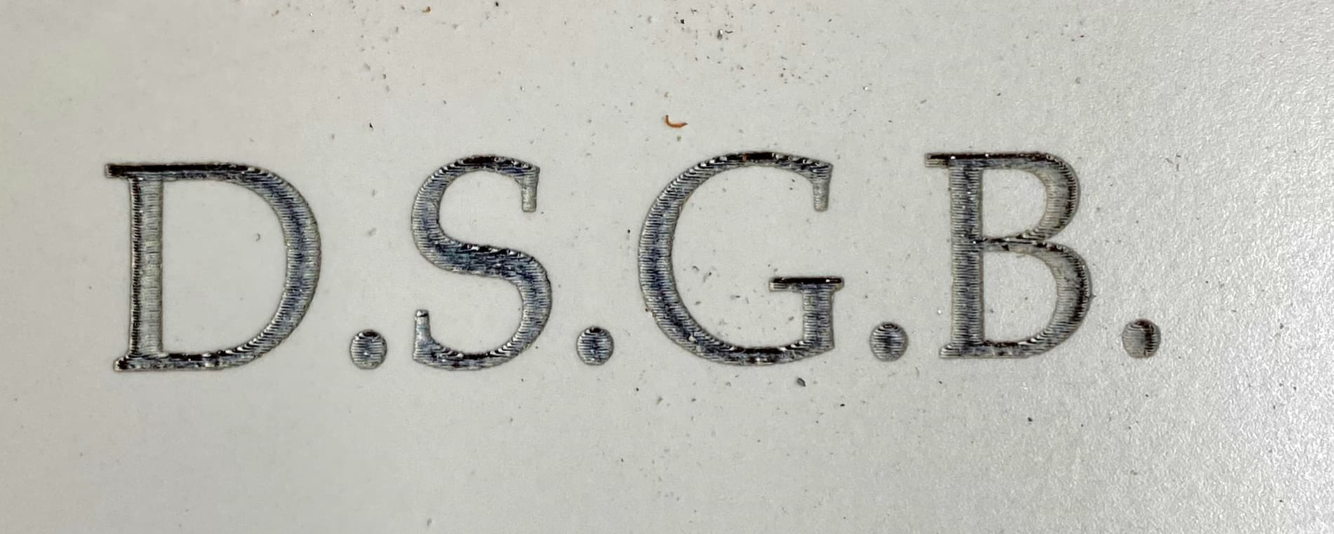

The first image shows it was lettering “D.S.G.B.” which was engraved at 50% of the 40Watt setting and the traversal speed was 1800mm/min. it appears to have given an acceptable depth of engraving, but could have been blacker.

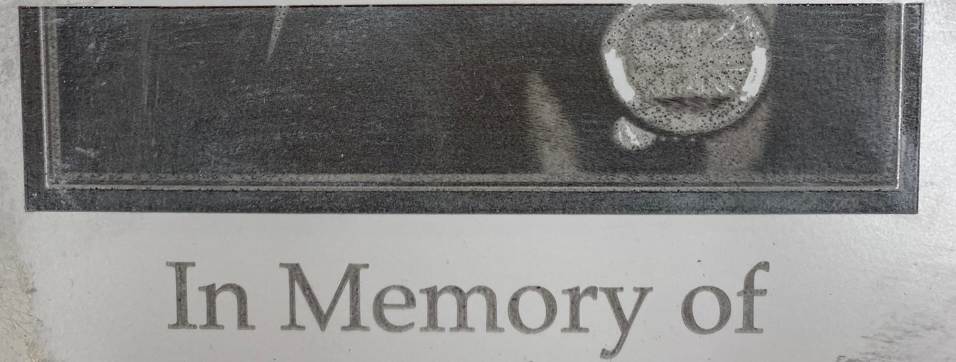

The second image shows The partially completed image and the legend “In Memory of”. The letter engraving is similar to the first image. The image looks and feels ok and you can compare it with the supplied grayscale image. Jarvis and 304 ppi. there was a lot of ‘snow’ after the burn and I had not seen that before. I only used a little acetone to roughly clean the engraved areas of interest.

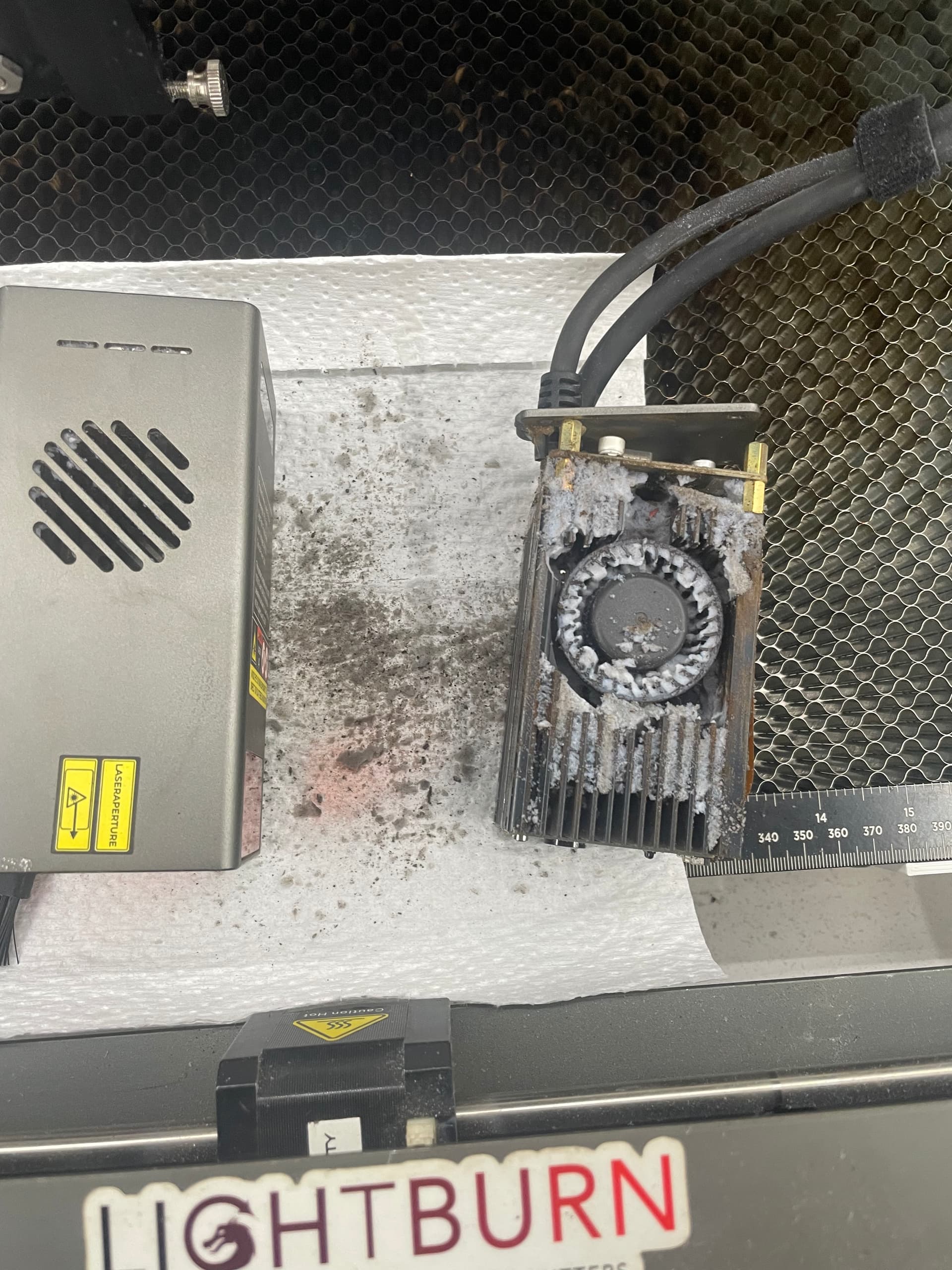

Bee careful engraving ceramic tiles and mugs. They put out a lot of ceramic dust that gets sucked into the laser. I engraved 8 ceramic mugs a while back and was getting ready to do 24 more. I happened to look at the fan on my Falcon 2 diode laser and saw it was solid white with dust. I had to remove the cover to clean it and I found the entire inside was packed solid with ceramic dust. I luckily was using low wattage on this job. If I had done another job on high power I would have burned up the laser.
Here is a picture of my laser with the cover removed.
Anybody burning rocks with a laser already knows this. Thanks for the reminder!
