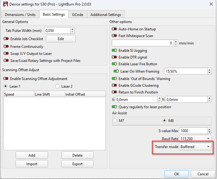

As an aside… I had an ALARM 11 stop a job yesterday. My researches tell me it is something bout a character space problem. Is there a place in LightBurn to set this?
I think it’s more likely caused by a bad usb connection. I’d check that first. You can check if buffered transfer is enabled in device settings, but it usually is.
Hmmm… Thank you Melvin. Brand new USB leads from computer to laser machine. I will swap a couple out and see if that has any effect. I did not find a device setting in LightBurn that refers to buffered transfer. Is it somewhere in the computer? I have been a Mac user since the 1980s and do not know anything about the Windows OS. I am using Windows 11 Pro for Lightburn and my CNC machine.
It should be in the device settings window close to the com port setting. I can check once I’m back at the pc tomorrow :grinning_face:
What a gentleman you are. Your help is very much appreciated. :+1: Thank you, Melvin.
It’s here:
