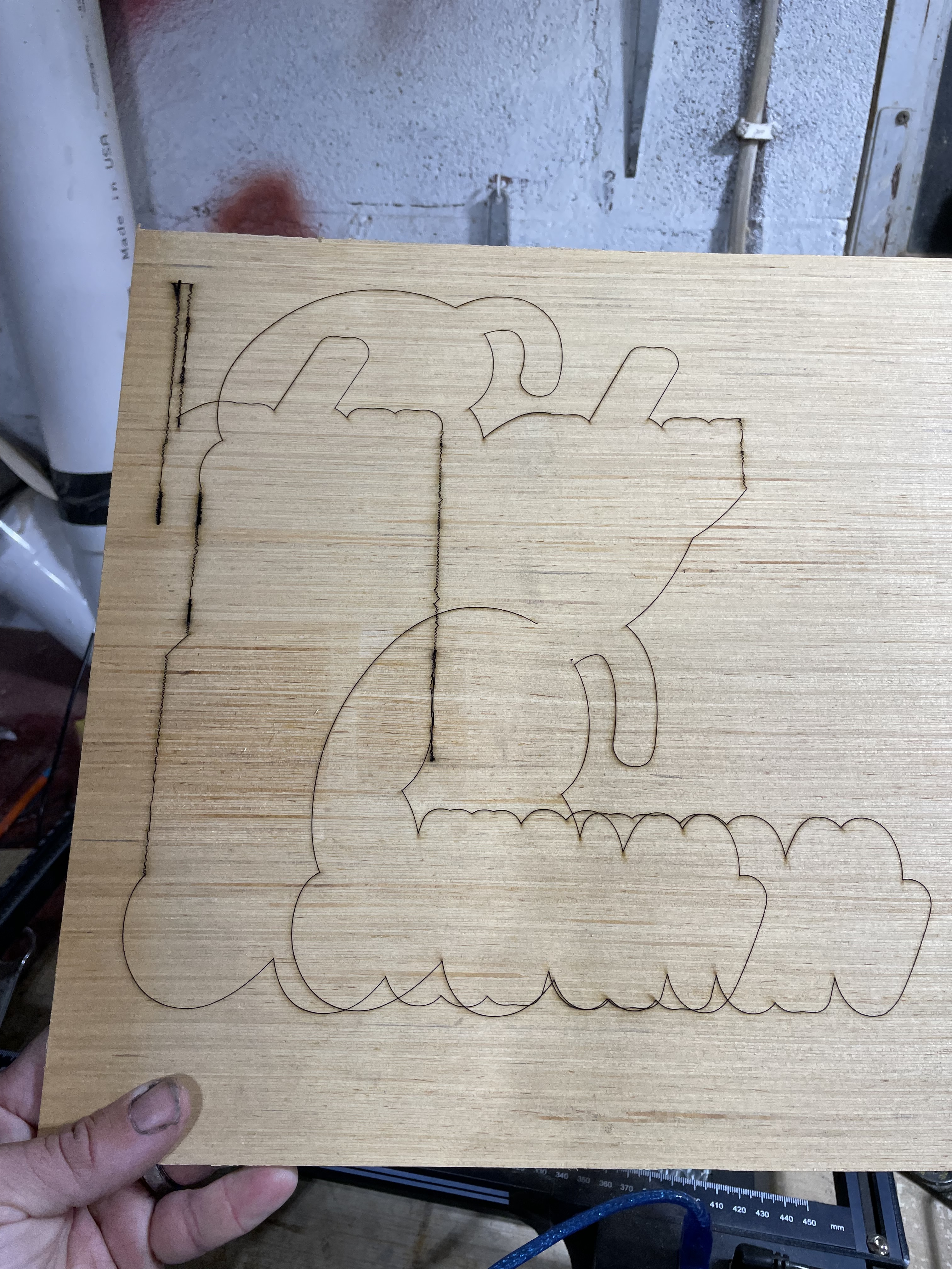

Sculpfun stopping in mid burn while laser is still on, burning zig zags in project
I’ve just been practicing to get my settings right. I’ve only had it for a month. I started on a project. The laser would sometimes stop and have a loud hum and stall while framing the project. While it’s cutting out the design it will stop while the laser is still on and go left and right burning zig zags in the project. I’ve checked all belts and I don’t know what the issue is.
A few pictures will help show us what that means.

Thank you. I did the tune up. The y axis was extremely tight from the factory. I was able to tune it to where the y axis to slowly slide down on the tilt test. Still havent been able to loosen the x axis to have it slide on the tilt test. Its still pretty tight. The bracket that tightens the belt seems to have no affect on it. Any ideas on how to loosen it.

This may not be a function of belt tension. This could be caused by over-tightened wheels for the laser module mount depending on the model of laser you have.

I have the s30 10w. I contacted lightburn customer support. I was told that the zig zags are from a pirated version of lightburn even though I downloaded my software directly from the website. After working with it. It seems like it only grinds in one area of the work area, upper right side. Anywhere else is smooth.
