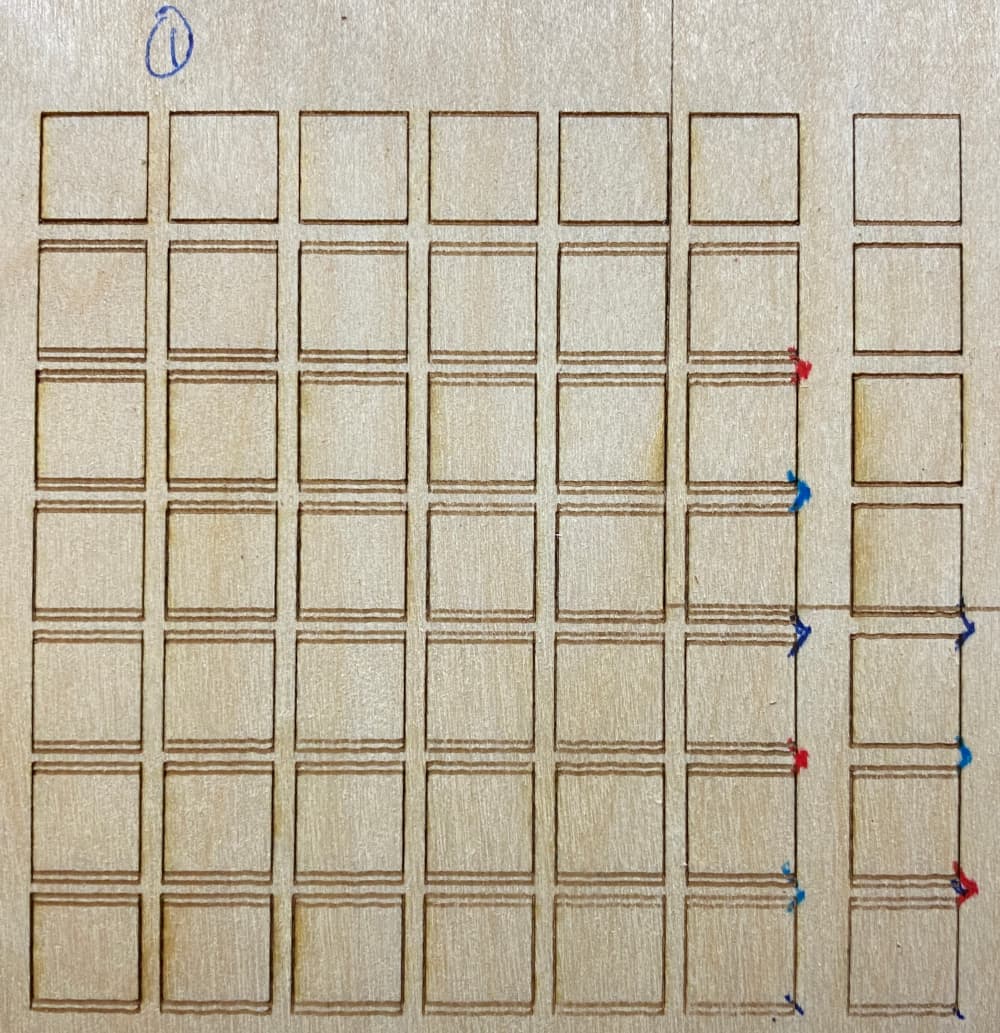

During all checks I noticed I was getting “wobble” in the X axis, so I adjusted the pulleys, again.
(bottom to top speeds are 2500-1000 in 250 increments)

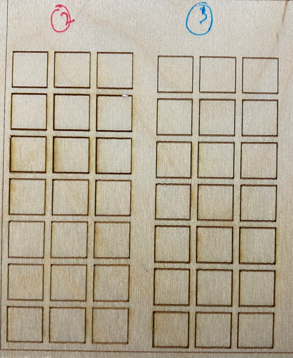

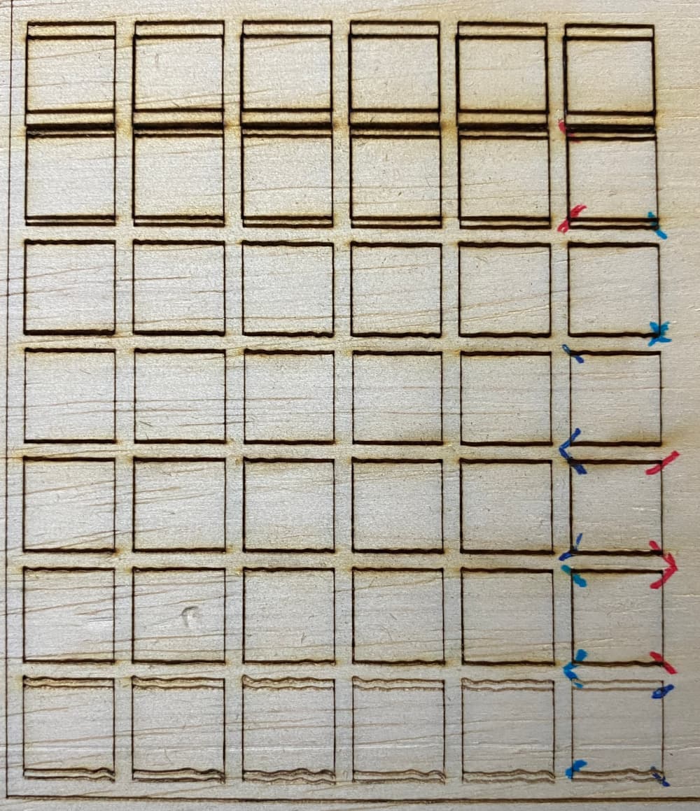

710 was the first batch of tests, the Y offset is very obvious. The colored marks reflect the different runs
711 (2) the laser repositioned to 0/1 and all successive tests were aligned properly; (3) I manually adjusted the position to 0/0, then changed the end point to X:250/Y:200, all tests aligned properly (note the Y difference)
712 was another set of tests that show how much X wobble I was starting to get

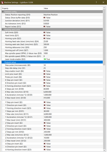

Are you saying the reported position would be 0,1 even after requesting 0,0? Or you somehow determined that it was 0,1 in some other way? If the former, that means the machine is keeping track of steps but is somehow drifting. Is it possible that you are overtensioned on the Y? Either the belts or the wheels. This could be causing binding and resultant missteps.
Also, can you check the value of $1 in your grbl settings? If this is too low your steppers could be relaxing too early and allowing ambient stress to shift position.
$1 - Step idle delay, milliseconds
Every time your steppers complete a motion and come to a stop, Grbl will delay disabling the steppers by this value. OR, you can always keep your axes enabled (powered so as to hold position) by setting this value to the maximum 255 milliseconds. Again, just to repeat, you can keep all axes always enabled by setting $1=255.
The stepper idle lock time is the time length Grbl will keep the steppers locked before disabling. Depending on the system, you can set this to zero and disable it. On others, you may need 25-50 milliseconds to make sure your axes come to a complete stop before disabling. This is to help account for machine motors that do not like to be left on for long periods of time without doing something. Also, keep in mind that some stepper drivers don’t remember which micro step they stopped on, so when you re-enable, you may witness some ‘lost’ steps due to this. In this case, just keep your steppers enabled via $1=255.

I’m not sure how/where to read the $1 value. Do I need to run GRBL on the same computer for each laser?
This is actually disappointing but seemed more likely. It will be difficult for you to try to correct for this each time though, especially to sub mm precision.
The actual GRBL settings are stored on the controller. So you will need to have the laser connected to your computer to be able to read this setting. Whatever laser is plugged in and connected (make sure you’re on the right port for that laser) is the one you’ll be querying.
You can read this in 2 ways:
  1. Edit->Machine Settings->Read
  2. Type $$ followed by the Enter key into the entry field in the Console window. This will list all GRBL configurations by number.
Thanx again for your assistance…

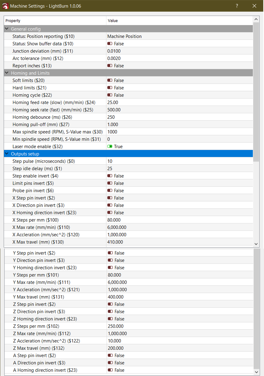

Here’s the GRBL data:
It doesn’t appear to have nearly as many entries as the Ortur 7W.
Take a backup of your settings. Try to change $1 from 25 to 255. Does that change behavior?
Be aware that Atomstack doesn’t allow permanent writes to these settings so I’m guessing this won’t survive a power cycle of the machine.

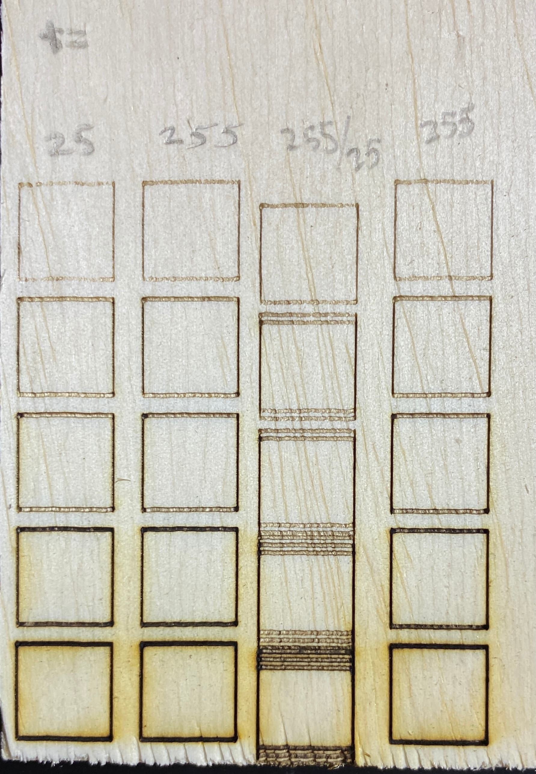

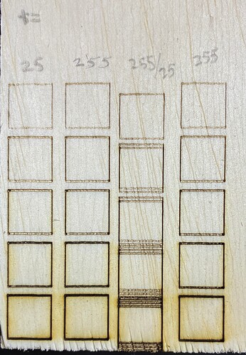

So I ran a new set of baseline tests before making the adjustment as suggested.
Origin = 0,0
Finish = 250,200
Test pass output:
Bottom to top mm/m: 1000/1500/2000/2500/3000; Run 1 1000, run 2 1000/1500, run 3 1000/1500/2000, etc.
In the pic: (ignore the pencil marks)
Column 1 was run starting at “origin” and default Atomstack setting of $1=25, and finishing the job as configured. As before, I checked the end position (all finished as configured), then selected “go to origin” before starting the next pass.
Column 2 was run starting at “finish” and setting of $1=255, and finishing the job as configured. As before, I checked the end position (all finished as configured), then starting the next pass.
Column 3 was run starting at “finish” and default Atomstack setting of $1=25, and finishing the job as configured. As before, I checked the end position (each pass was off progressively by ~-1mm, thus the visible differentiation)
Column 4 was run again at the same settings as Column 2, just to validate the outcome.
So it seems that either a) setting $1 = 255 (every startup, since as you say the changes aren’t permanent) or b) verifying that I start every project, regardless of original pass or a successive pass, at 0,0 (which is probably what I should have done from the start, rather than relying on the “smart” equipment to know it was correct)
