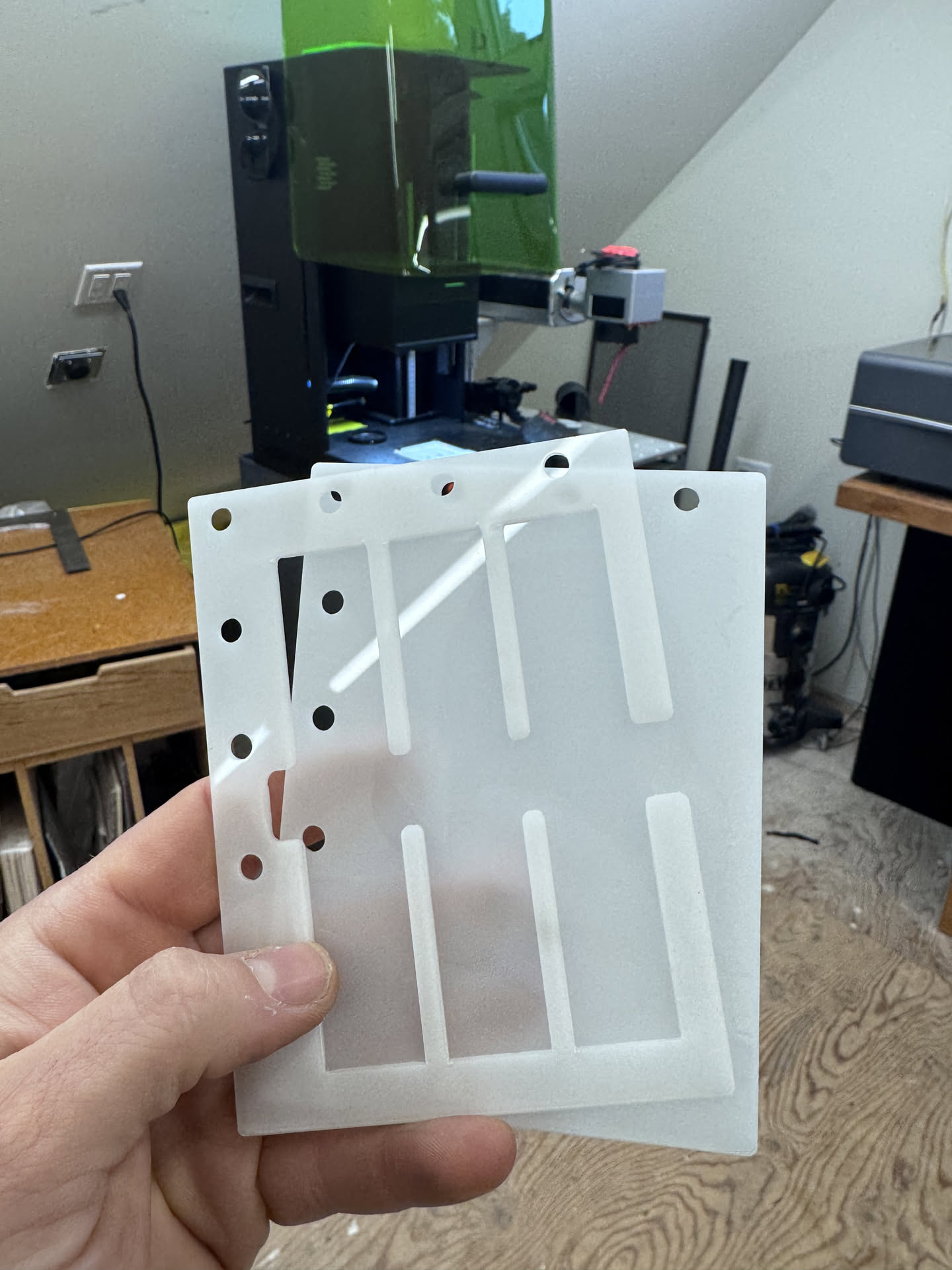

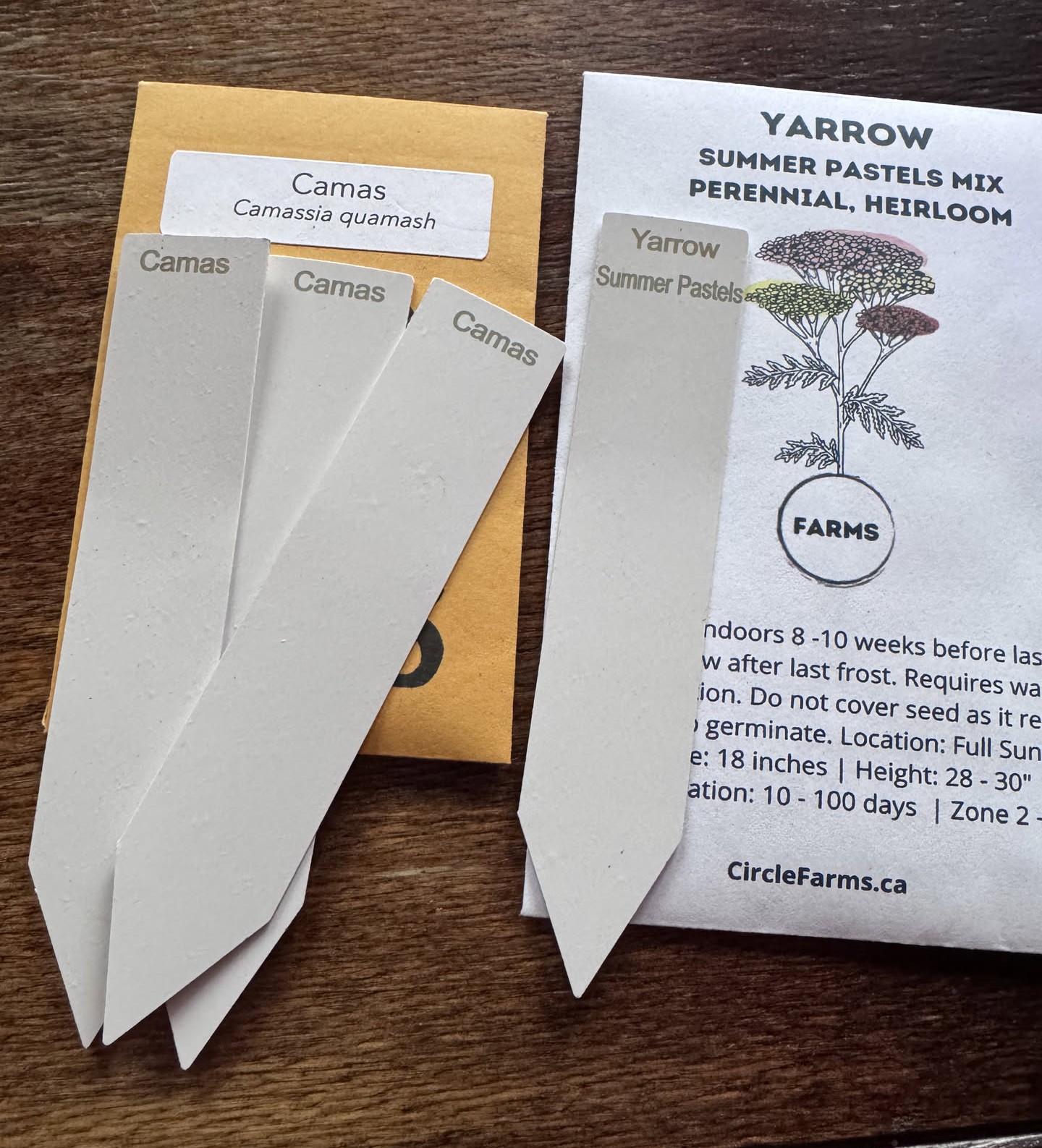

Over the weekend I made a jig and processed a batch of seedling markers utilizing my Spark SP1300S CO2 laser for the jig, and the Commarker Omni X 5W for the markers.
Attached is a sample .csv, the fixture file, and the etching file. Entirely designed in LightBurn too.
You can get the plant labels on Amazon or Aliexpress
Utilizes Variable Text with two columns. Learn more about variable text here: Variable Text - LightBurn Documentation
If I was making the jig again, I would use slots instead of holes to allow for finer adjustment of the position. The mounting holes worked great, but because the position is fixed I was unable to use all 3 slots of the jig.

Nice! and the jig securing is excellent.
