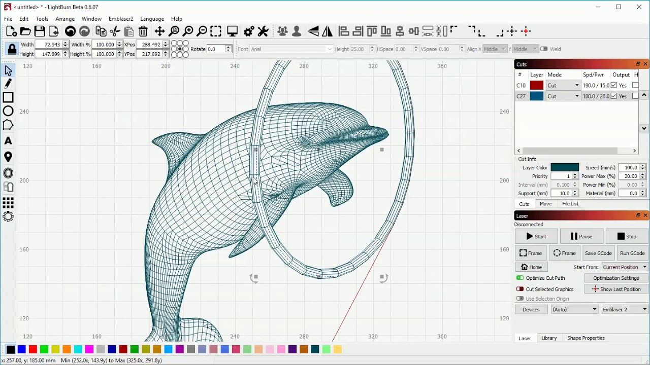

Have a DXF that I have imported that is filling in an odd way. I created the DXF, have used it for other things successfully, so have no idea why it is behaving the way it is. Hoping someone can explain what I need to do to correct it. I have gone through it and removed all duplicate lines, as well.
I have attached three images. One is what is should look like. One is what it does when LINE is selected, and the other is what it looks like when FILL is selected.
Thank you for any assistance.
Looks like there may be some duplicate shapes in your design.
Try selecting everything then Edit->Delete Duplicates.
Yep. Did that earlier. No love.
You need to trim those lines and join/close the resulting shapes.
The T looks lighter than the rest of the letters. Zoom in and look off offsets. Or apply offset to T.
I completely overlooked the T. Jeez, it must be late.
The T is interesting to me as a newbie. I could not find anything wrong with it. I ended up grabbing the start/end node and putting it right back where it was, and that made LB happy. :man_shrugging: The other stuff… not so much…
I have been doing exactly that since I originally posted. No love. I’m stumped. That’s why I posted here.
Have you tried auto-join. Dxf’s have a lot of open lines that need to be closed.
Thanks everyone. Finally got it. Bit of a PITA, but I’m sure it’s because I’m new.
