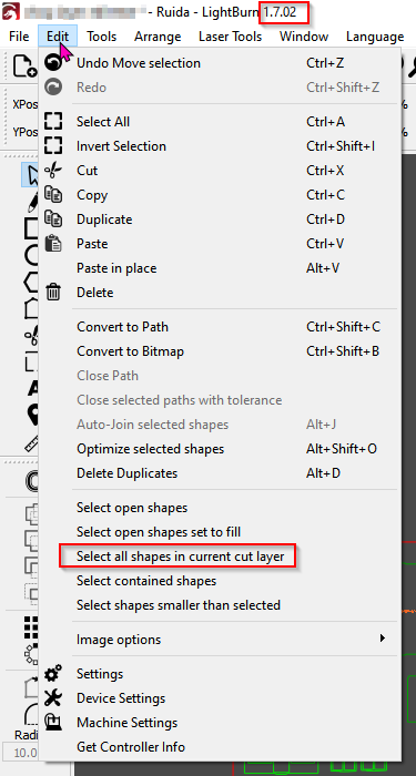

However, since “time is money”, I’m always looking for ways to streamline my production workflows, and unfortunately the behaviour of “select all shapes in the current cut layer” of ungrouping objects containing the selected layer doesn’t fit my “MO”.

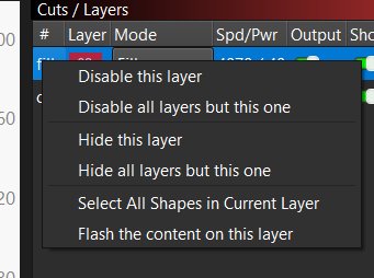

In LightBurn Core 2.0.00-RC-4 there is an option to select all shapes of a certain layer, if you right-click on a layer in the cuts/layers menue
In version 1.07.8 there isn’t.

Thanks for the info, Tilman…but I do see it under Edit in 1.7.02.

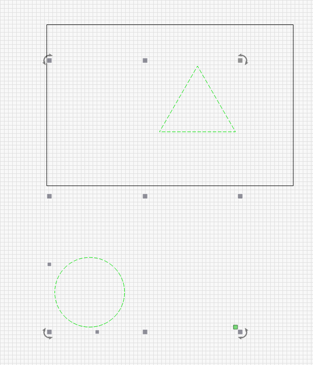

But in my example, the triangle and ellipse are on layer 03 and the rectangle is in layer 00. The triangle and rectangle are grouped, viz:

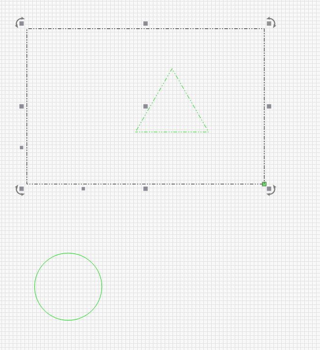

If I then select the ellipse and click “select all shapes in the current layer” (or shift-click layer 03 in the Cuts/Layers window) then this is the moment when the triangle and the rectangle are broken apart (as hinted at by the change in selection):
Thinking about it some more, I suppose that the concept of selecting objects within a group doesn’t really exist in LB currently.

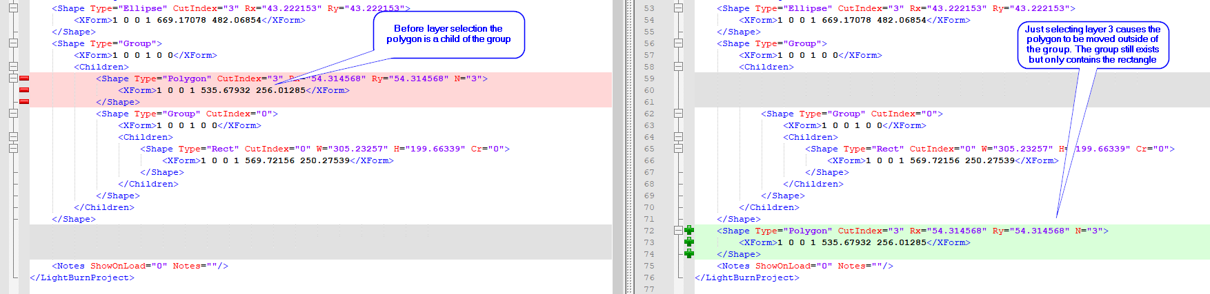

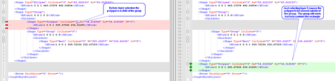

You can see from the comparison of the LB files before and after the layer selection has been done that the “polygon” shape was removed from the group object:
I have also experimented with directly editing the LB file in Notepad++, doing find/replace on the appropriate “CutIndex” entries to change the layers and preserving the group structure. It kinda works but risks screwing the drawing up. I would rather be able to do such a “find/replace” within LB!

Editing the file content to change the CutIndex property is safe, as long as the destination layer already exists. If you assigned to a layer that didn’t have a corresponding cut setting in the file that would probably cause some issues.
