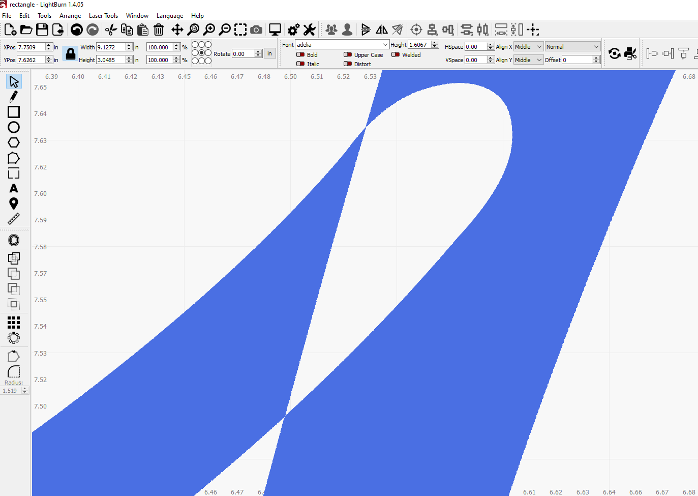

Hi All, I am trying to work with some script type fonts in Lightburn and noticed where the one letter flows into the next it is creating an overlapping unfilled area that I want filled. I can’t figure out how to fill this space in. I have tried creating a layer of the same shape over it, but then I seem to have an unclosed path issue. Anyone know how to fix this? Image attached. Thanks

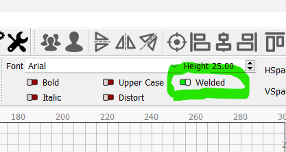

Turn this on.

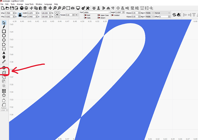

What Bikemike said. Likewise, if the text has already been turned into paths or you have the same issue with shapes, use the boolean weld function. Circled in screenshot.
Thanks a lot! So simple…dang. Fixed!
