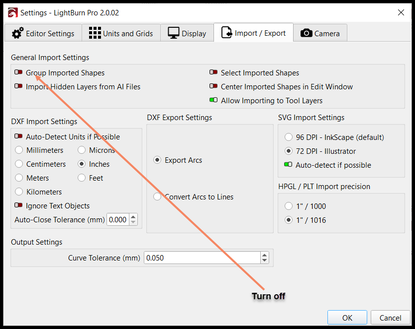

So have just downloaded and updated Lightburn to Lightburn Core 2.0.04 and have imported some graphics to play with, for some reason when i click select on the import it selects the whole of the import not a section i want, is this a new feature and have to take different steps to select a certain part i imported. Either that or i am missing something, can anyone enlighten me.
You need to ungroup your import, and it has always been like that. ![]()

For selecting a part of an SVG object, grab whole object. UNGROUP as far as you can. Red box select the part you want to keep. Move aside. Use red box select to grab the parts you want to remove, delete.
Select your desired parts and GROUP to make moving and editing them easier.

Thank i will turn that off and give it a go.
