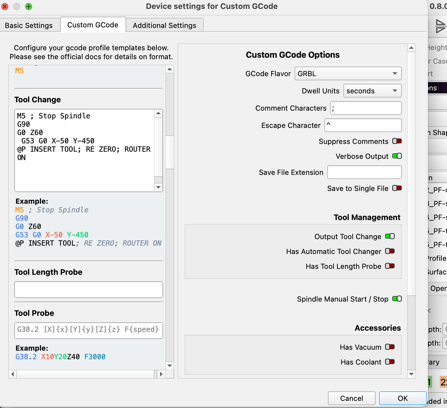

trying to have a semi auto ,manual tool change myself with the help of chat gpt! it now goes to a speacial spot promps me to change tool but when i go to hit the probe button as i normaly do for z -zero, only it says to configure then after that, when i press start it just keeps going round and round incuded is what im running …genmitsu 6050 xl plus .

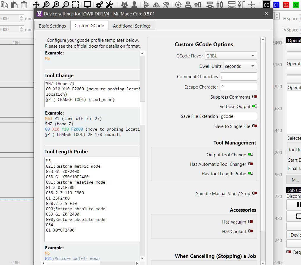

you don’t have any commands in tool length probe, to instruct it how to probe

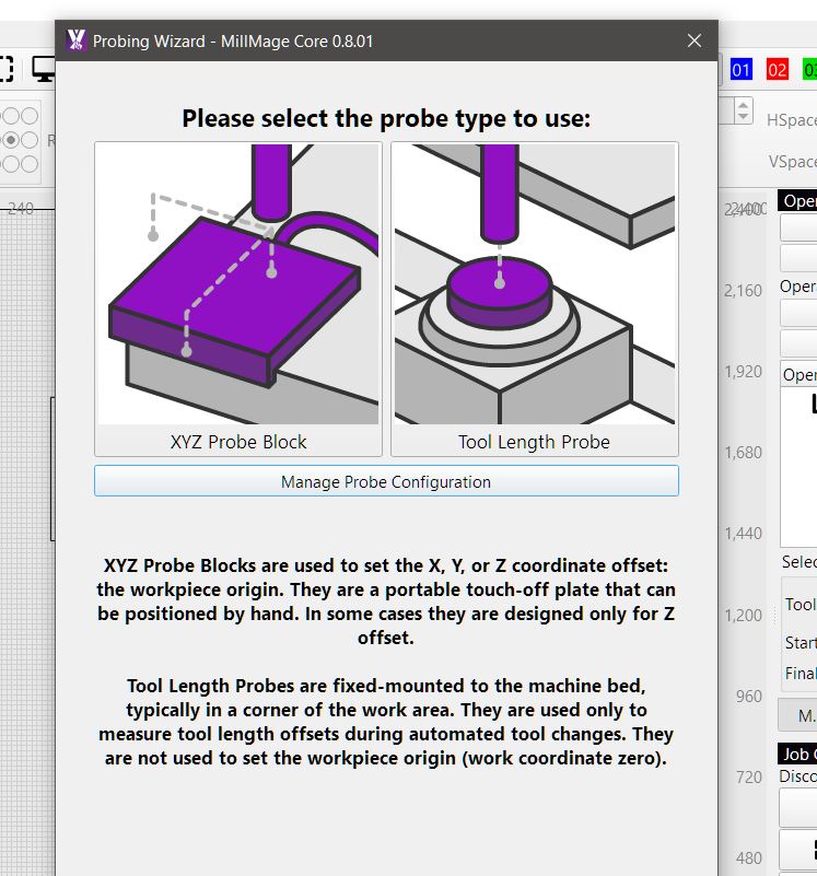

don’t know ur machine but if you have touch plate try using the probing wizard under the cnc tools tab , this is how mine looks using the wizard

in tool change you have @P INSERT TOOL; re zero ; router on

this is MM telling you dont have any probe commands set up and you need to configure using the wizard or enter your own custom codes as i explain in last comment , MM wont probe without codes in tool length probe box

im picking it says skip because MM has followed the tool change command and as it has no other commands to follow it only gives you a skip option , once you set up probe wizard the pop up should give you probe and skip options

is this what you were using prior to starting with MM, put those codes in tool length probe box and try it
remove theses: re zero ; router on , why do you have G0 Z60, from what ive learnt you should home Z always when doing tool change try changing it to $HZ
tool length probe button you may have to toggle this on
from my experience using your machines probe code can become an issue, best to use MM probe wizard set up. once you set up wizard you will need to manually enter you probe block thickness

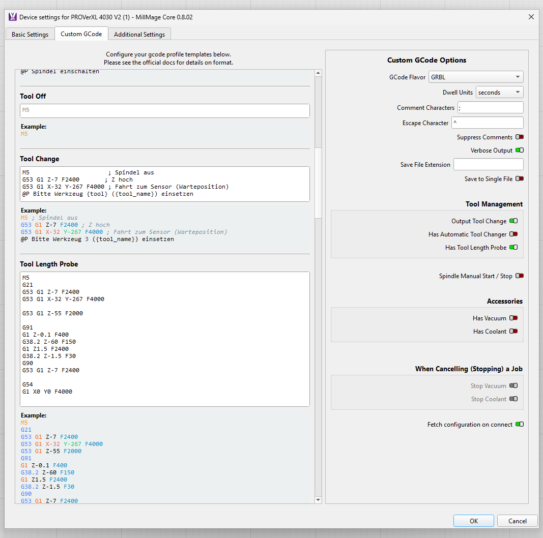

Hi Pat,
I hope you don’t mind me jumping in here. I’m from Germany and I think I might have been in the exact same boat as you are right now. Dealing with the MillMage settings for the ProVerXL can be a real headache.
I’m running a 1.5kW Vevor spindle, and just like you, I have to handle all the spindle controls (start/stop and RPM) manually via the VFD and potentiometer. Because of that, the biggest challenge for me was getting the CNC to perform a ‘clean’ stop for the tool change and sensor probe without getting locked by the software logic.
I’ve finally got it running flawlessly now. I’ve attached a screenshot of my current configuration for the tool change and the tool length probe. The key for me was to fully define the routine in the ‘Tool Length Probe’ box—once I had the right sequence there, the software stopped locking up and the probe button finally worked as expected.
A quick heads-up: Please make sure to adjust the coordinates (G53 G1 X... Y...) in the code to match your specific machine’s setup. My values are calibrated for my ProVerXL 4030 V2, and they might differ from your machine’s layout. You definitely don’t want the machine trying to hit a position that doesn’t exist on your frame!
I hope this helps you get back to cutting! Feel free to compare these with your settings.
Best regards from Germany!

can you put up a screen shot of you custom codes

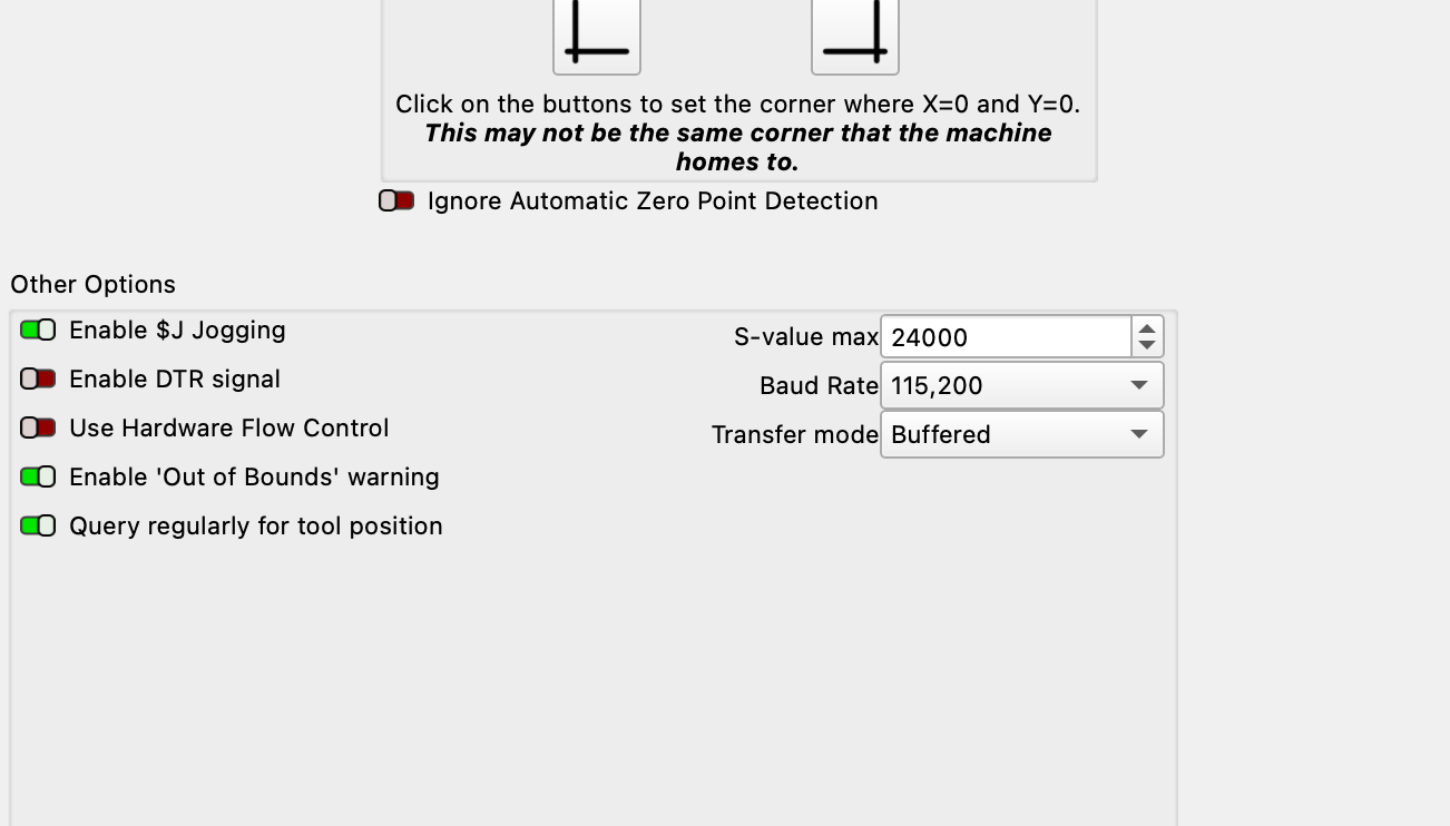

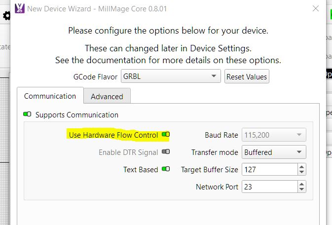

have a look at you device configuration , with my machine flow control needs to be on or all weird things ocur sometimes on updates it auto offs , that could be some of the issue also

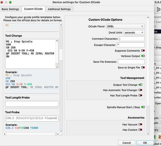

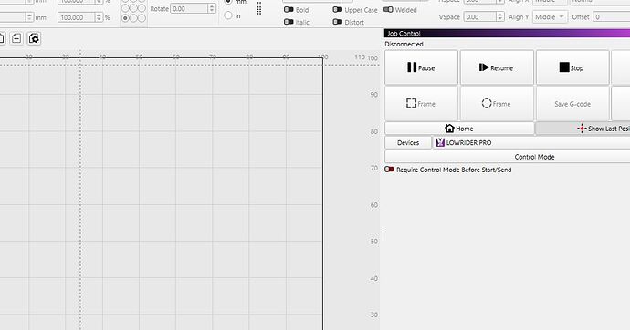

this is what I see not like your photo is this in a different spot ?
yes different spot but smae functions , didnt think about going in that way , you can go into the device tab and toggle through
ok , thats way out of my league now, mine has a sulk if nothing in there, could be machine and MM not communicating each other
have read of that dtr and hardware flow control
mine are both enabled
