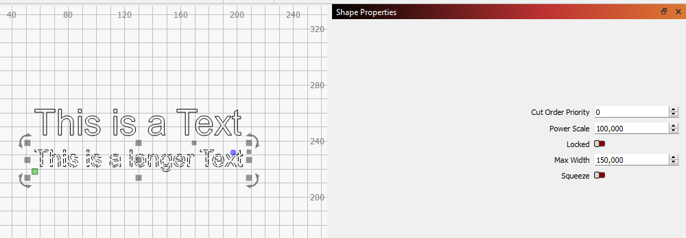

LightBurn 1.5 has a new feature in shape properties to retain the same size for text objects and either retain the aspect ration (reduce text size) or squeeze the text:
Both texts here have set a maximum width of 150 and I typed some more text into the second one.
