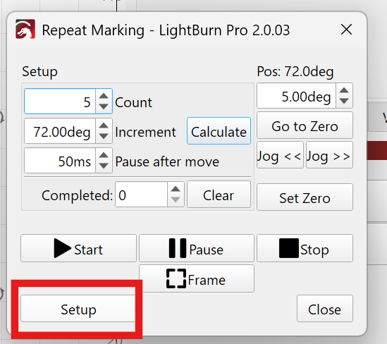

LightBurn will calculate the motor steps to degrees when you enter the “Steps per rotation” in the Repeat Marking setup:
Use the Jog buttons in that window to level your first side and “Set Zero”. (I see the smallest possible Jog step is 0.01deg, but that should be precise enough.)

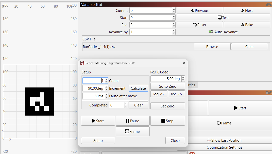

My suggestion is as follows (I haven’t tried it myself on the Galvo, but should work):

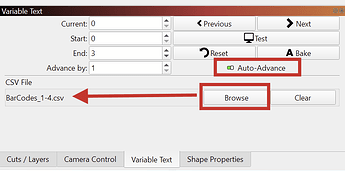

  • Create a CSV file with the desired barcode values, each on a separate line. Or use this one:
    BarCodes_1-4.csv (12 Bytes)
  • Go to “Window > Variable Text”
  • Enable Auto-Advance and click on Browse to select the CSV.

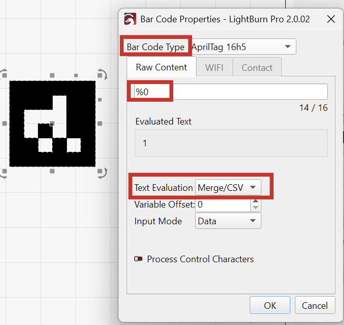

  • Draw a Barcode
  • Select the Type (I chose AprilTag 16h5 here)
  • Enter %0 in the Raw Content (that’s the variable for the first row of the CSV)
  • Change the Text Evaluation to ‘Merge/CSV’.

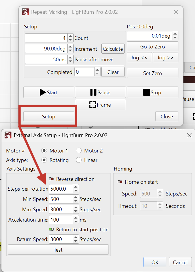

Now, open “Laser Tools > Repeat Marking”.
Click on “Setup” here:
Set up your External Axis, and enter the correct Steps per rotation for your rotary.
Set the Count to 4 and Increment to 90 degrees… You get the idea.
Let me know, if that helped :slight_smile:

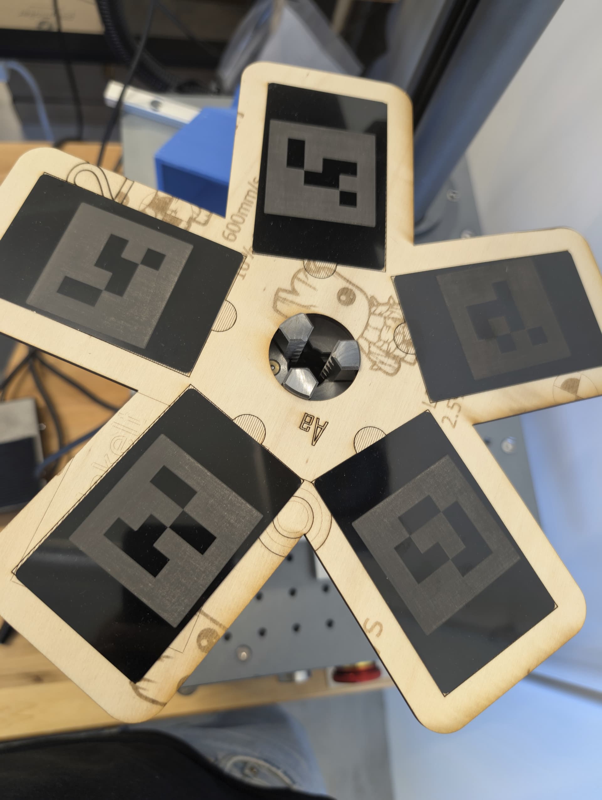

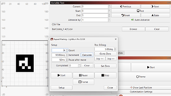

Hi Mike,
In the meantime, I’ve confirmed that my instructions are working!
This is Variable Text feeding the Barcode Generator and using Repeat Marking
