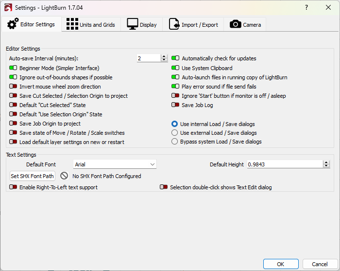

Do yourself a favor and turn off beginner mode. It opens up several settings that you currently cannot control.
