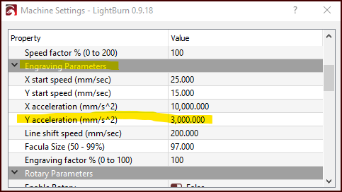

Is there a setting in the software where one can control the amount the laser travels past an image? I have a rotary piece that has a lip. I would like to engrave on the side but I feel the laser will hit the lip after each pass as the laser travel past the image. I hope I am clear on what I am asking. I am not sure the technical term for the travel after the image on each pass. Is it overrun?

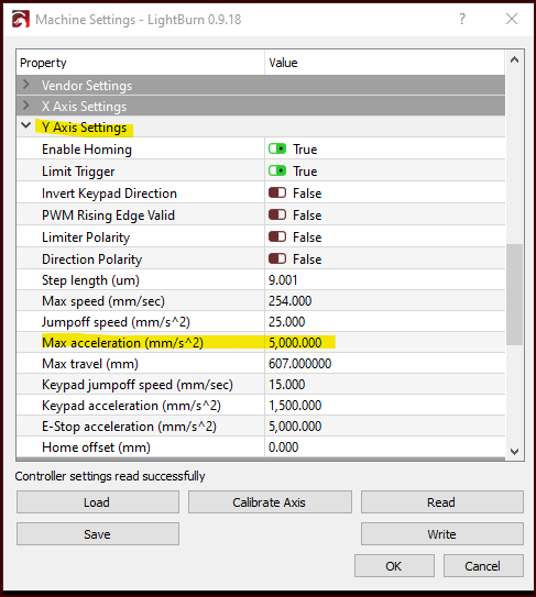

If I am not confusing things (because sometimes these settings confuse me) the controller determines how to manage speeding up and slowing down motion by the acceleration settings provided. Lower number = longer time / longer travel. Higher number = shorter time / shorter travel. Too low, and your machine is inefficient. Too high, side effects could be skipped steps, mechanical wear, backlash, etc.
You will need to look at the acceleration settings in two places. Of these two places, the effect or setting that will take precedence is the lower value while engraving (highlighting Y if you are sharing Y with your rotary):

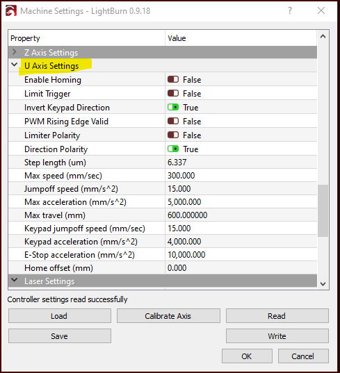

If by chance you are using U for the rotary on an updated 6445 controller, see the U axis settings:
