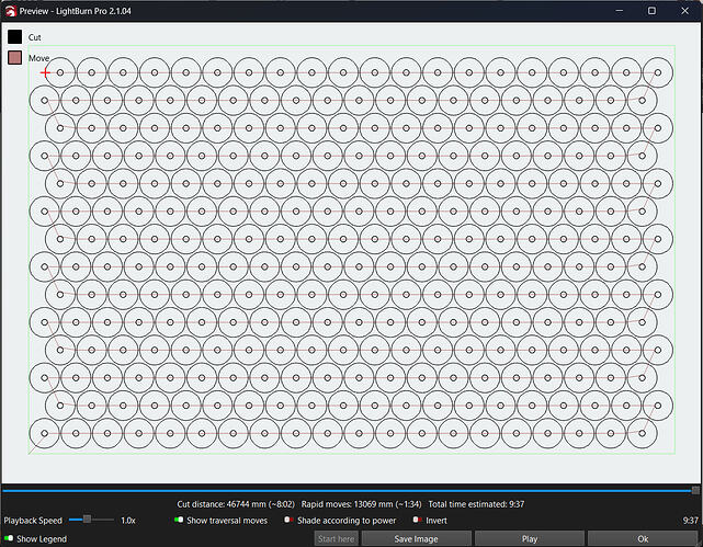

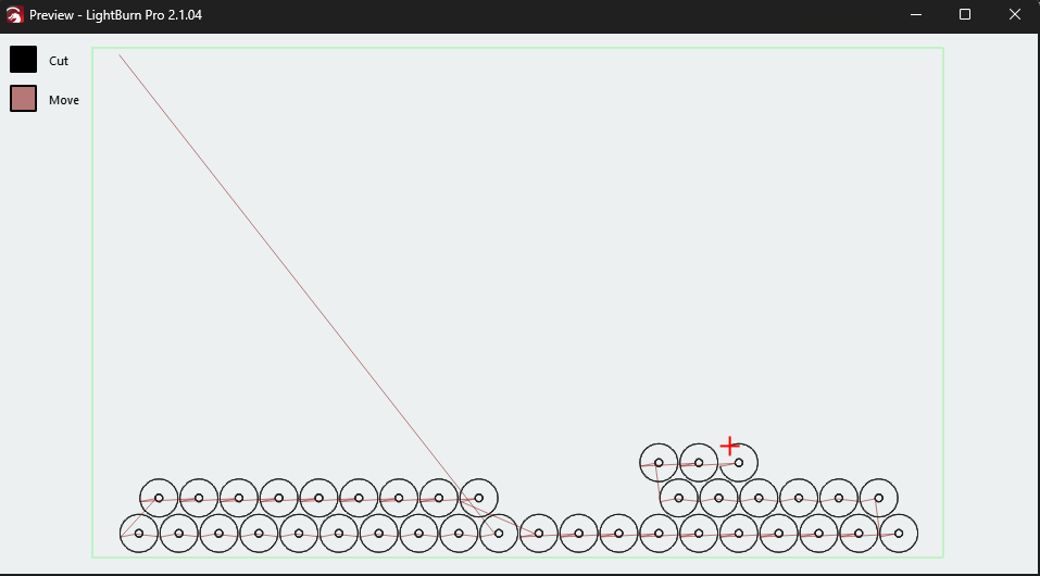

I have a file which is an array of parts. call them washers for simplicity sake. I would like for the program to start in the lower left and work all the way to the right then start the next row up from the right and work all the way to the left. how can i do this?
the current optimization settings start roughly in the middle of the bottom row, works left then goes up to the next row until it gets to the start point then jumps back down to the first row to finish going to the right.

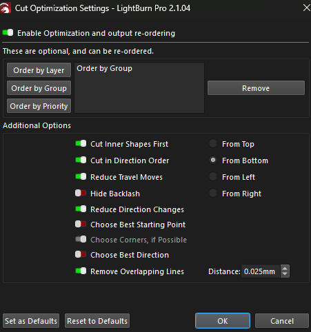

I have each washer inner and outer diameter grouped as a single item and my optimization settings are below. Is there a way to do what i want thru optimization settings or otherwise? or do i need to create a layer for each row?

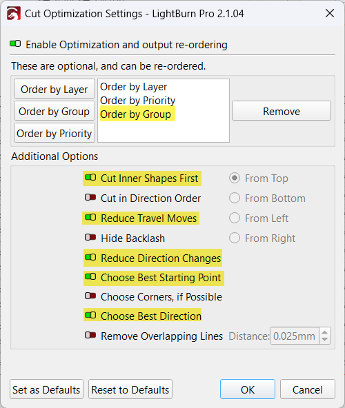

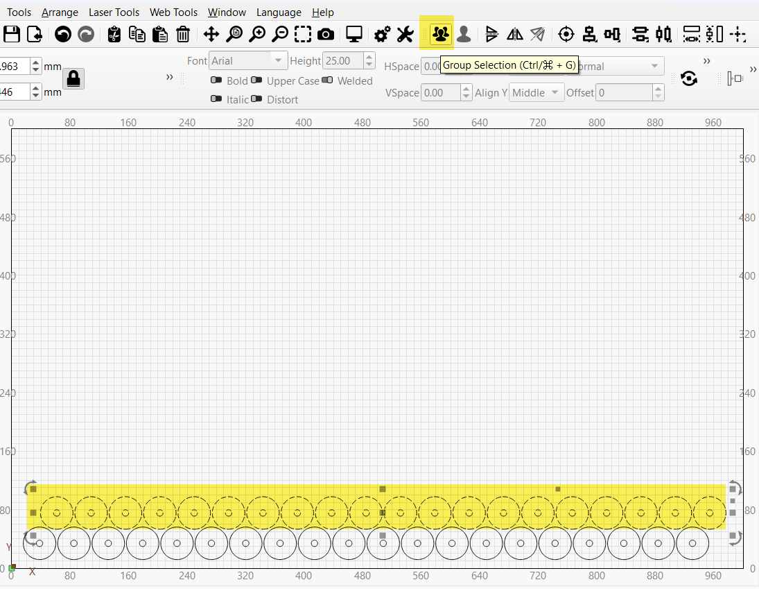

Please consider this method which uses ‘Order by Group’ to help steer the optimization:

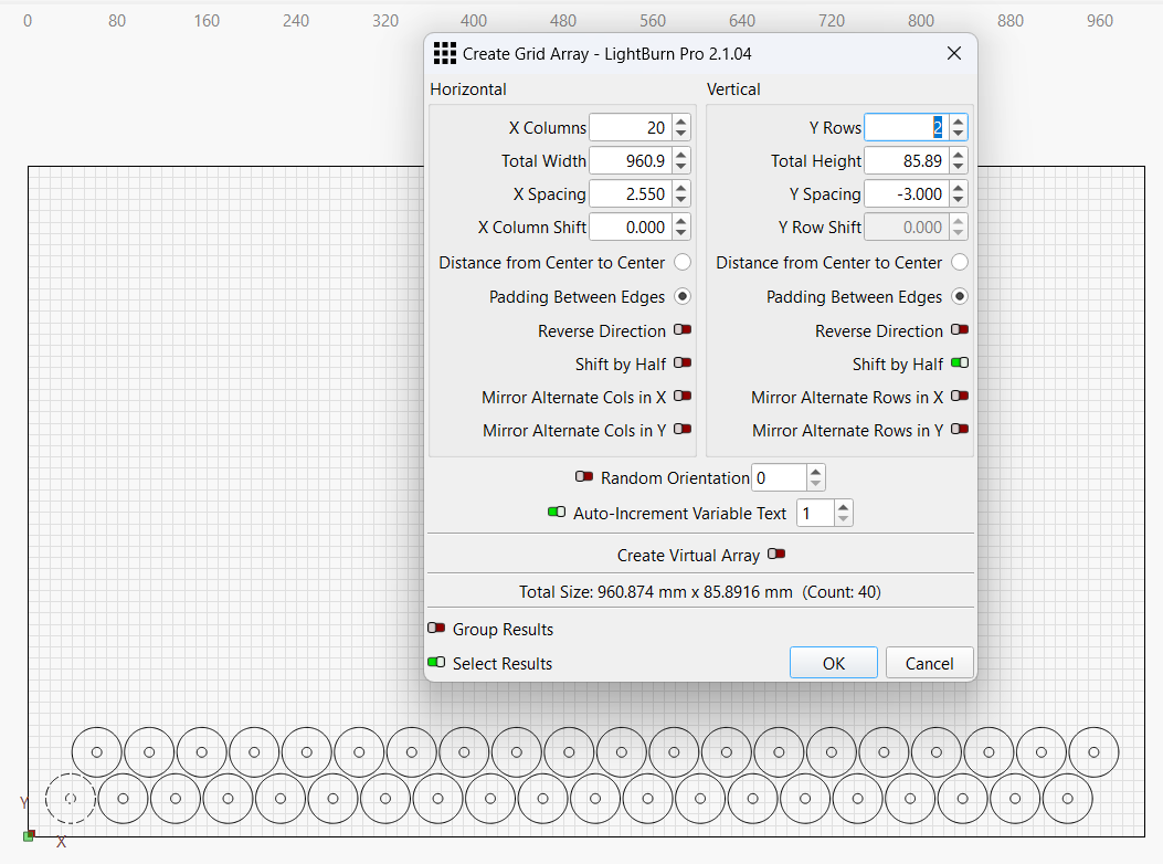

  1. Create the first two rows:
  2. ‘Group’ each row:

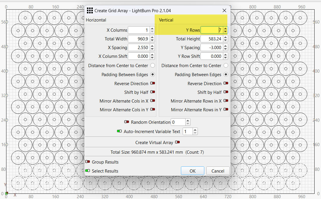

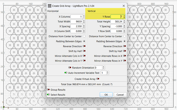

  3. Array-copy the two groups upward to fill the sheet:

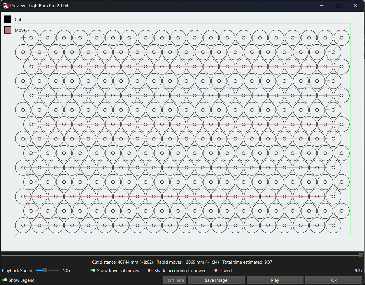

  4. Enable Optimizations. Especially enable ‘Choose Best Starting Point’ and ‘Reduce Travel Moves’, and make sure ‘Order by Group’ is included:
  5. That’s it! The job will start from the closest corner to the origin:
    2026-08-29_12-08-51
This is a perfect response. Its basically what i did but i added a couple steps in arraying the first 2 rows (your method is better btw). I turned optimization setting off though so it automatically follows the order of creation. So im curious if you turn optimization settings off does it follow the same pattern?
PREVIEW window will answer this question.

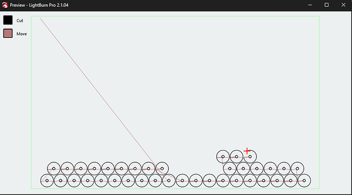

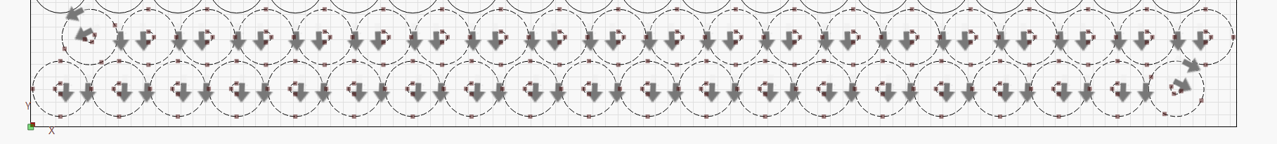

It doesn’t, but you can do that, and it helps if you set up the startpoints:
Notice above that the second row has been mirrored so the start and end points are on the left hand side of the circle, and I just rotated a couple of the circles to help setup a transition to the next row, here optimization is off:
