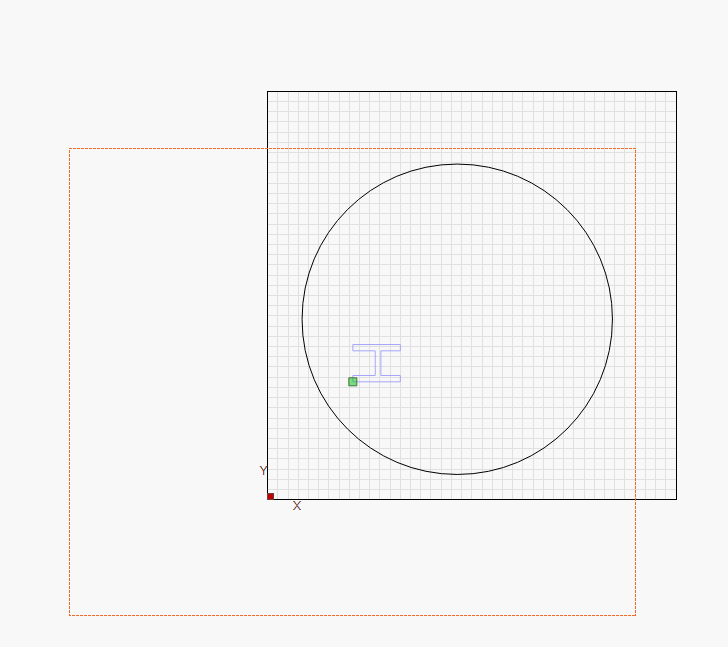

Lets say we have this object and want to put a circle around an existing H on a round tumbler.
You can set the origin as the corner of H as thats an easy spot to work out.
So id expect it to follow like the red line from origin and move but instead it does the green line. From user origin but moves as if it was at the job origin.
Theres no easy way to set the job origin to start from the user origin in this case as none of the 9 points line up with anythng you can reference. The only thing to do would be maybe measure the distance you need to travel to get to centre and measure to the edge of the round object and move the rotary to this position which is a bit of trial and error compared to referencing the actual object you want.
So for this example the easiest way is to make a much larger rectangle and position it around the lot so the centre lines up with the user origin like this which doesnt seem like the best but it works

Yes, that is the current workaround, which for the most part seems to be serving everybody well.
Just be aware that using T1 and T2 layers for this workaround may create framing problems. Like this example;
If that happens use a spare ordinary layer for the shape you are using to stage the job origin and toggle off the output for that layer (and also turn off ‘Use Selection Origin’).
