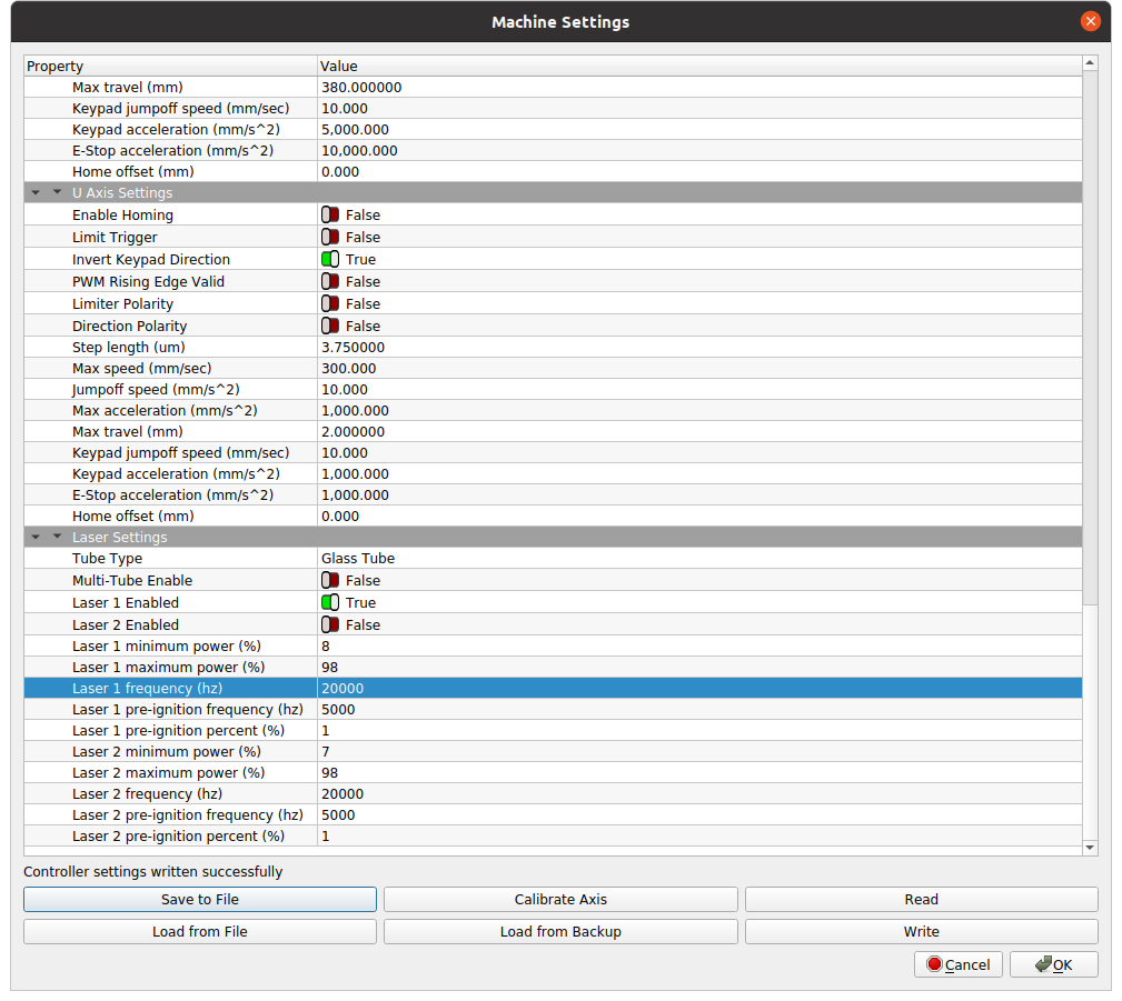

I’m going to be installing hardware onto the Y axis that will impact the front of the machine if it travels that the farthest Y coordinates.
To prevent this from happening any under circumstances, can I simply reduce the “Height” parameter in the Device settings?
Yes, there is a Y maximum travel, Max travel (mm) … in the vendor settings …
This is for the U axes, but it’s the same name under each of the axes groups…
