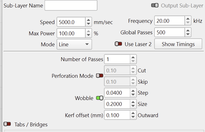

This is what I’m using to cut 0.75mm stainless on a 30W fiber:
  • You might need less than 500 passes
  • low frequency for high power output
  • Rather fast speed
  • Big Wobble steps
  • Kerf offset to compensate the Wobble.
You can add a “Pause Before” value under “Show Timings”, but I didn’t need that if you have a blower fan transporting away the heat

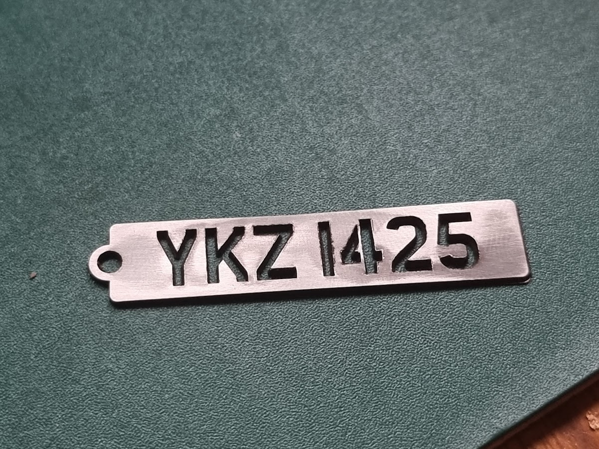

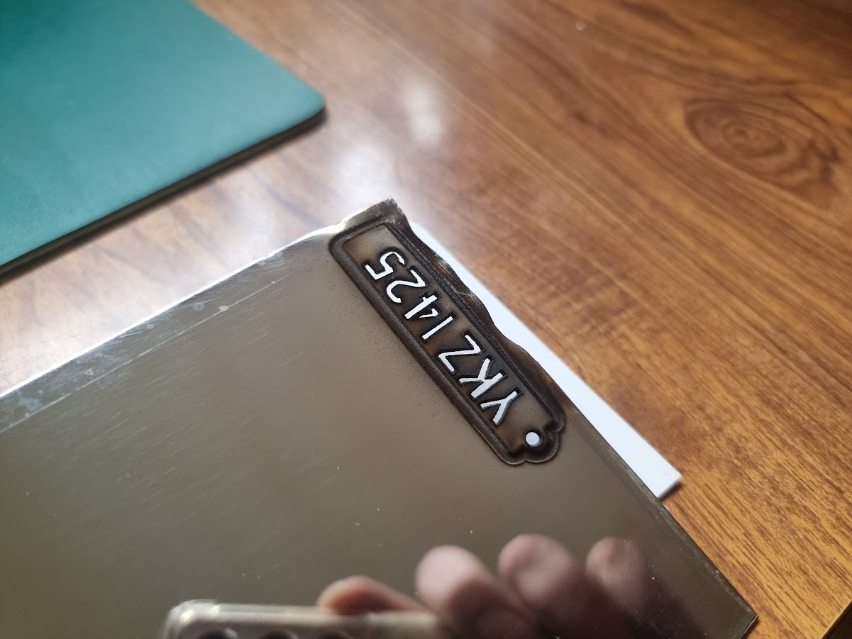

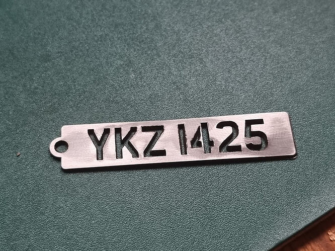

I did manage to cut that stainless out, letters engraved out fine but had to nurse the cut as it was just folding over with heat. Its very low power engrave or i need to figure out something else in regards to 1-1.2mm stainless as at the moment i cannot cut it reliably without massive deformation or insane cut times. I’m pretty sure its just my ignorance of the topic and lack of testing, which i will do coming weekend. Any advice on cutting stainless is appreciated. I think i got the brass fill cutting down more or less…
Pic below, it engraved fine, but upon cutting out perimeter it warped material between letters so now its wavy and i’d need a press to fix it…

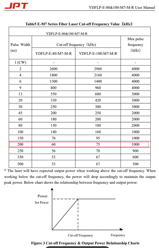

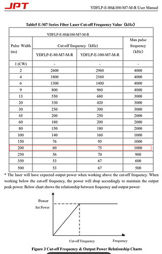

I don’t know if this could be an issue or not. It might not be doing what you expect. I noticed your frequency/q-pulse is below the threshold.
This is from an 80/100W JPT M7 MOPA manual.
Not knowing exactly or even in the ballpark of the technology, it seems upside down.
