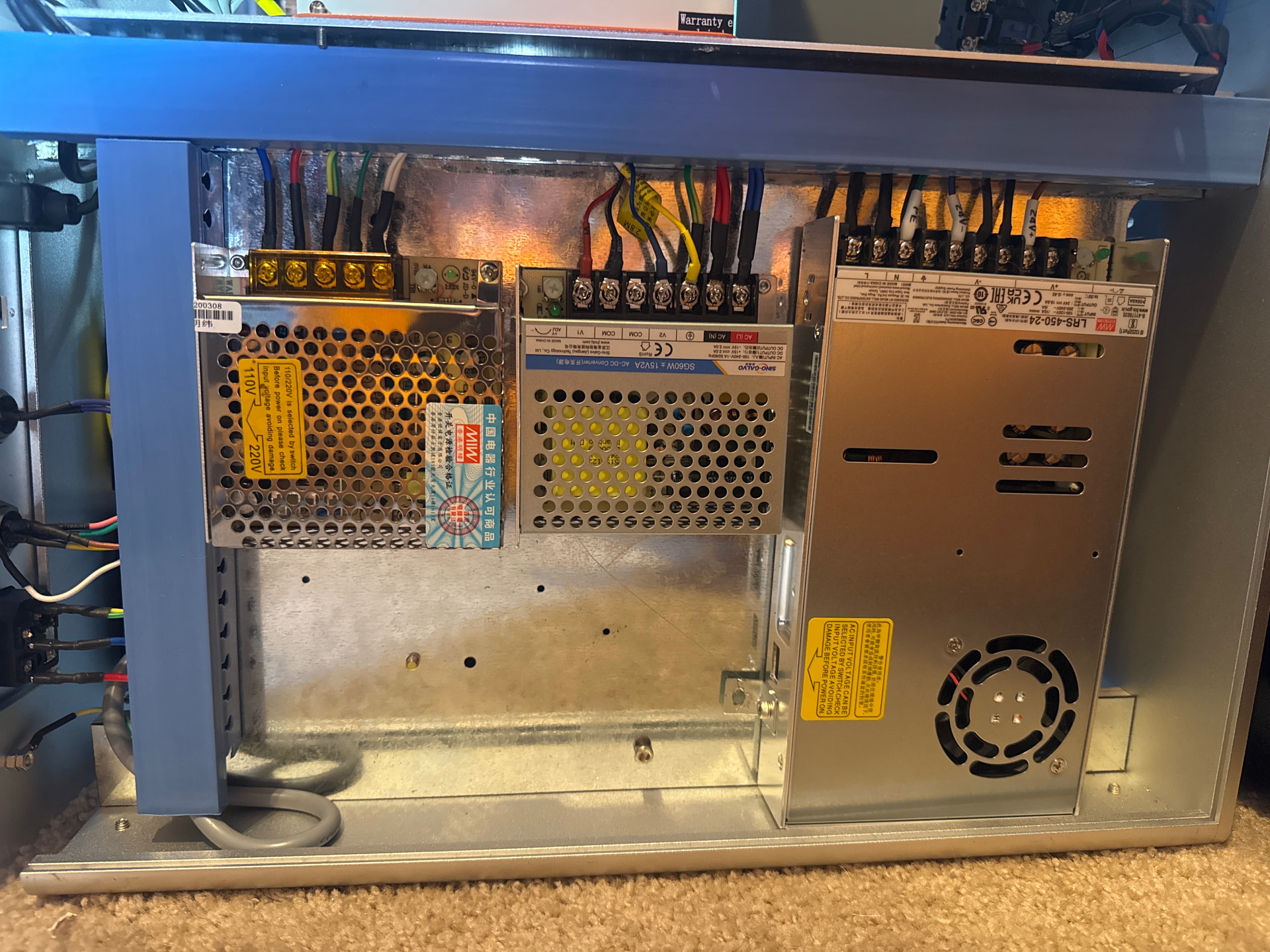

I have a 50w raycus fiber laser that has been working great since I got it 2 months ago. I finally got a rotary chuck attachment for the laser this week. Upon opening the attachment, the rotary had a 4 pin connector and my laser has a 5 pin male port. I opened up the laser console box and found that only 4 were connected so I swapped the 4 pin connector to a 5 and left the corresponding pin empty. Since then, I’ve only been able to get humming from the rotary chuck when I test it in light burn. I’ve tried swapping the paired wires to see if polarity is an issue but that doesn’t help anything. I can’t seem to find what the issue could be. Has anyone experienced this before or does anyone have any idea what the issue might be?

When you had the case open, did you look at where the other ends of the wires went? If you open it up again, take a bunch of photos. Specifically the DIP switches positions on the microstep driver, the table printed on the top of the driver, the wires on the driver and back of the plug, etc.
Good morning, Sir
It appeared that the wires all ran up to the BJJCZ board af the top of the case.
I didnt see any dip switches anywhere. Would they be inside that bjjcz housing? I’ve built computers in the past, but these pieces are all new to me. I appreciate your time and help.

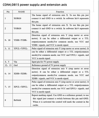

OK, Usually there is a microstep driver in the case, Looks like one of these. Might be a different color or shape but you should recognize it. This goes between the BJJCZ board and the rotary stepper motor.
What follows here may seem like a lot of information, but if you are sure the wires ran to the BJJCZ board it is set up for an external microstep driver.
First need to confirm a few things:

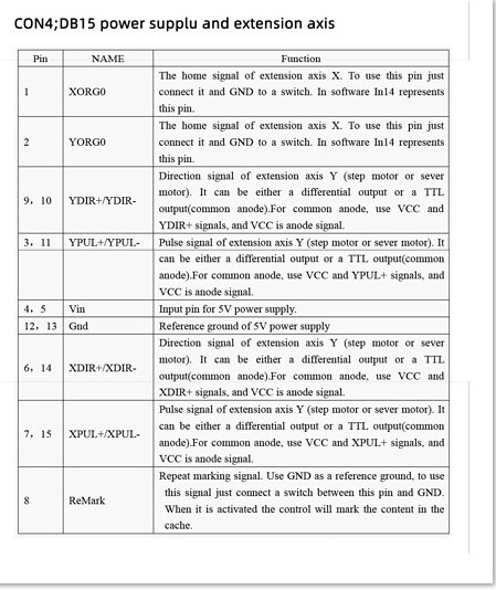

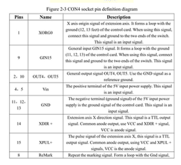

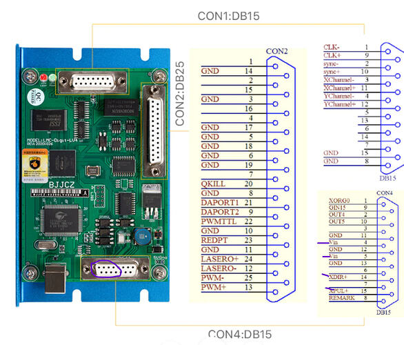

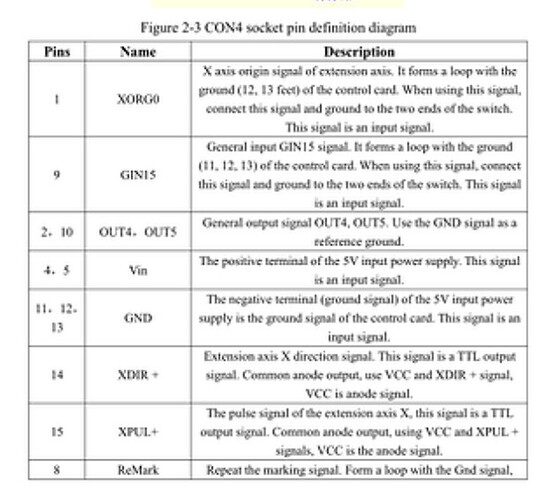

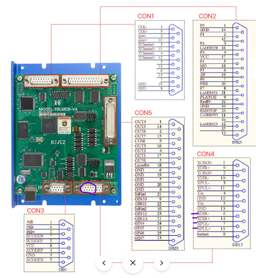

Is this in the area of where they connect?
This is a BJJCZ “Lite” or “Original” board.
May use the ground instead of the Vin, lots of arguments about it but mine uses the Vin as common though and has been solid for several years.
On a “Standard” BJJCZ board they would be here and do use the (-) just to confuse the issue (But not the ground).
This may be a bit of a process, but if your case does not have the microstep driver inside, you will need to either make up your own external controller (basically a microstep driver and a power supply) or may find a ready made setup. Here is an example of an external controller type rotary:
with a little more searching you may find a controller without the rotary. Easy enough to make one though and save some $$
Good luck, reach out with any questions. Don’t get too overwhelmed.

I agree. Here is a photo that I took the last time I had the case open.
Next time you have it open take a photo of the top and the BJJCZ board. Looks like plenty of room to install the microstep driver. A lot of setups pull power off the 24V power supply, but if possible it’s better to add an additional one in my opinion.

DM542 spec, photo in earlier post.
