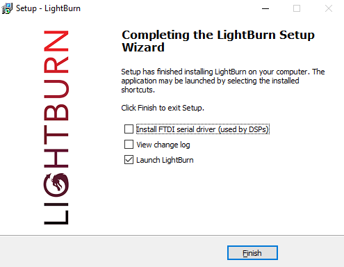

I have just reinstalled the software just in case there was an issue, and noticed there is no box to check to install the ezcad2 driver for galvos. So I assume this could be the problem?
Not sure how to solve if I it is. I have bought the PRO version to cover all machines.

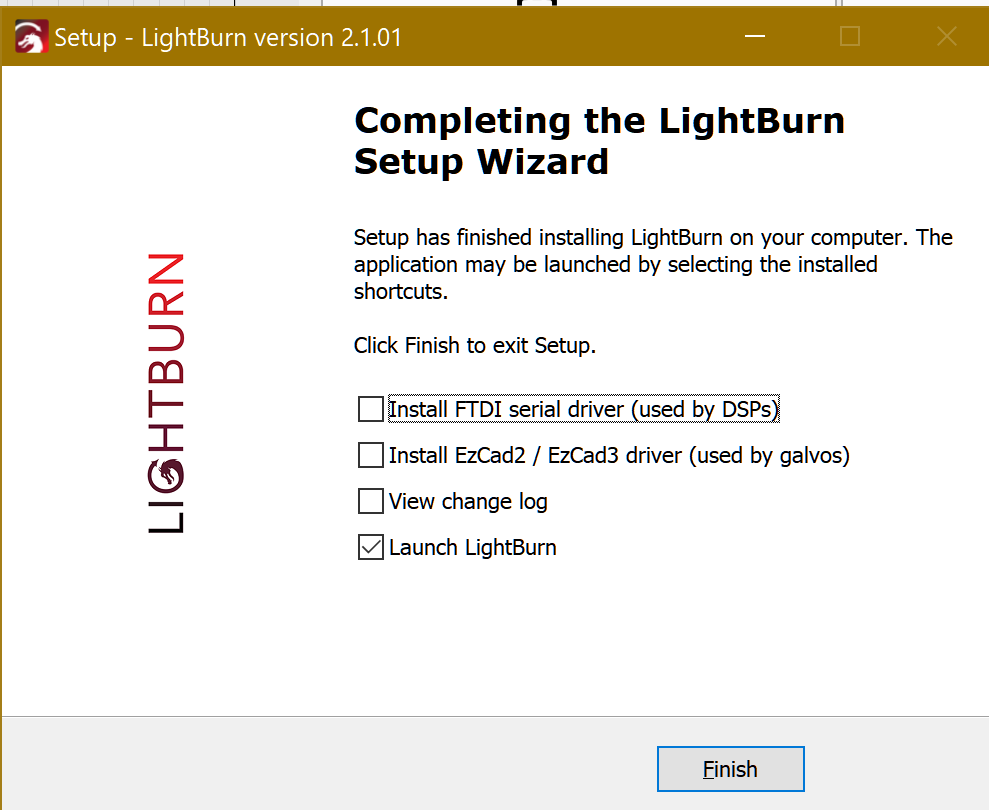

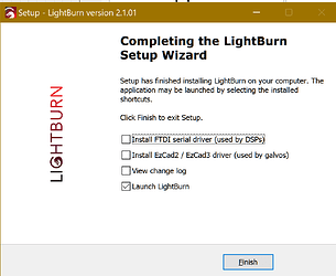

The last screen of the installer has a set of checkboxes:
Are you Installing 2.1.01?
This is the issue. I do not get that option at the end of the setup as shown here from my screenshot.
Never mind. I have redownloaded the software from the website again and its no working! WEIRD!!! But at least we’ve got there. Thank you for your help!
