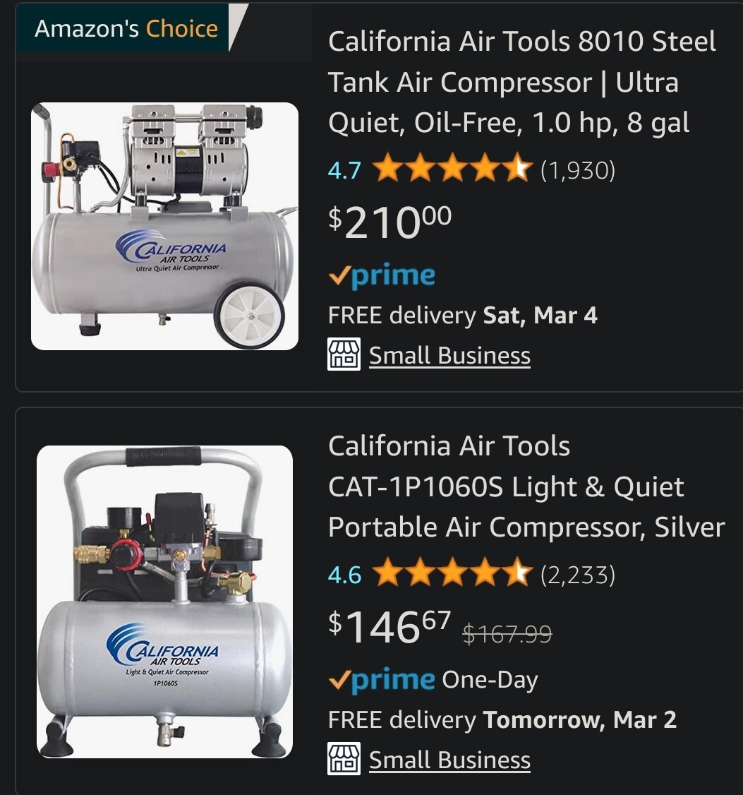

I used a Husky home compressor for 6 to 8 months, but it was so noisy I purchased one from California Air… they are not low cost, but are very quiet…
Probably more than what you need… it will supply 60psi for a cut no problem…
Good luck
Yeah I just saw they had some smaller models as well.
The nice part is they are very quiet compared to most of them… the bigger the storage tank the less it will cycle…
