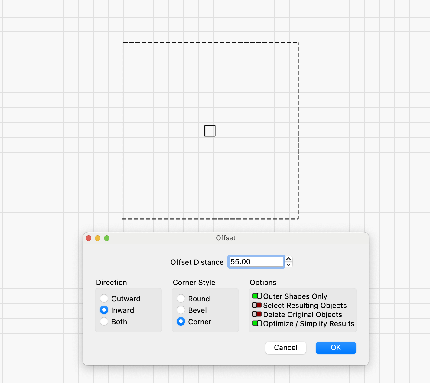

I have a square coaster i want to engrave, i want a small line around peremiter, with engraving in center.
I know i need exact measurments of coaster etc, im wanting to know how i set that up in light burn.
Maybe it’s the offset function that you can use, the distance from the edge is determined individually.

In my opinion you need to create a jig. Set Lightburn to absolute coordinates. Measure your item and place the square on the work area. Affix a piece of cardboard to your laser bed and run the line/perimeter of your item on the cardboard. If you’re on a raised bed where you can cut through, do that, otherwise just mark it for reference. Change the line to a tool layer, then right click and lock it in place. Place your design within the tool layer and use the alignment tools for proper placement. Place your workpiece within the engraved line or cutout, focus and run it.
Ok, now I’m in the case :wink:
The easiest will be if you can use “Absolute Coords”. Here you place your template with a corner in home position, ie. 0: 0, cuts out your first item and save your template (physically) and as a project.
If you do not have a static machine bed, use “Job Origen” and manually fine -tune/frame your project until the template fits your new coaster.

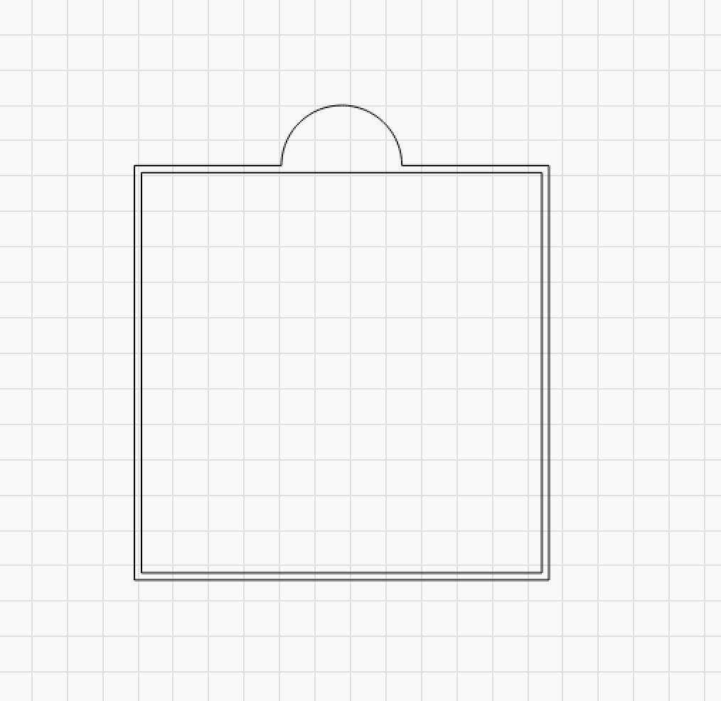

I have a plaque, it has factory routered edges,say its 4x6 inches in size, i want to engrave in the centre of the plaque, how do i set up the laser to do that?
Many ways to achieve this. Here are a few.
If the plaque has straight edges, exactly the same as the square. Measure, engrave jig, place graphics. You may want to subtract the routed edge distance from your jig so you don’t go beyond that space.
If it has a scalloped or other, not straight shape, take a photo of it, straight on, directly overhead and import that into LightBurn. Trace the image and scale it to size in your work area. Use that to place your jig and graphics.
Another option, depending on the shape is to make a rectangle the plaque just fits within. It likely has points on each edge that could be used for alignment.
