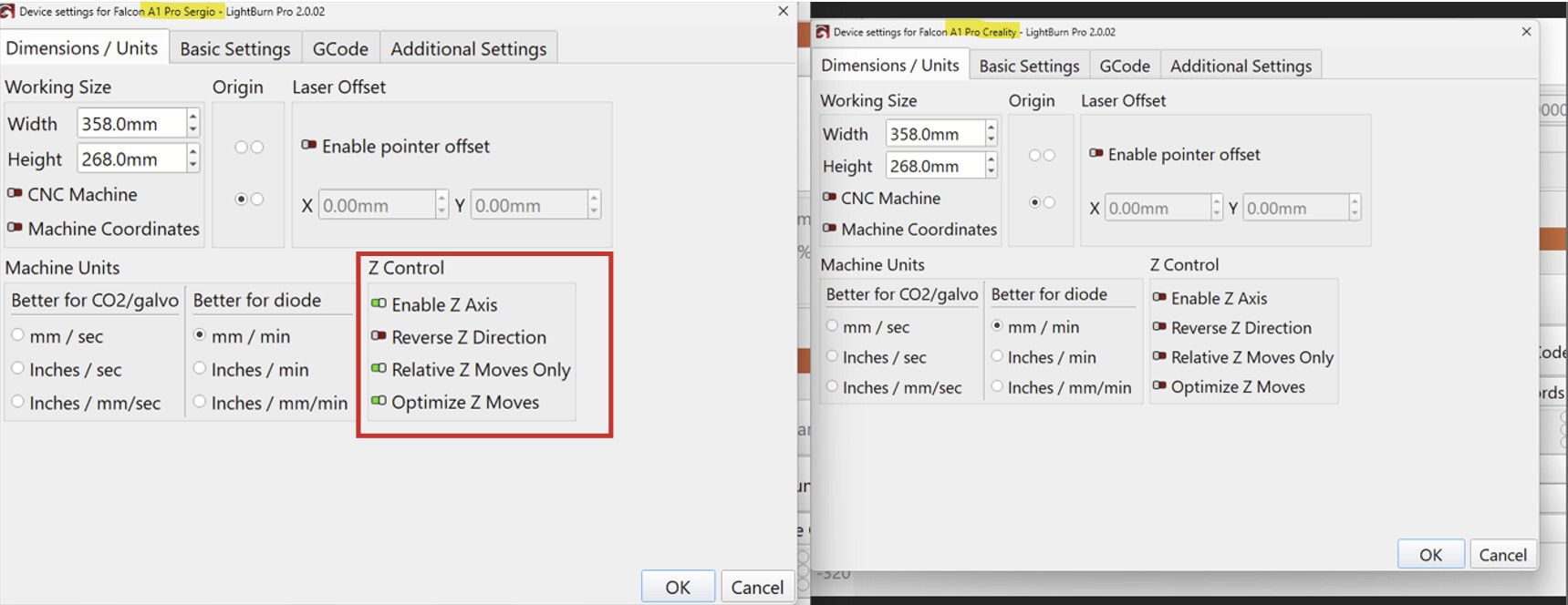

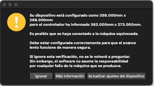

As you can see, as soon as I start the machine, it throws up an error message about the size of the work area, as well as a message that I was told to ignore.
I’m attaching a file that Creality sent me, since I was configuring the machine as GRBL and it was GRBL-LPC according to Creality. When the machine automatically searches for it, the controller indicates a different size and only GRBL.
falcon_a1_pro.lbdev (19,4 KB)
The following file is the machine image. Once I uploaded the Creality file, I configured some parameters. While engraving, it failed for the first time at 10% power and 100 mm/min speed, not giving a flame error and giving the other errors. I managed to finish everything by removing the entire 100 mm/min test line.
I attached the configuration file when it gave an error
falcon serjforius configuracion.lbzip (5,5 KB)
I attach the current configuration file, if I need to change any parameter or perform any test, I am at your attention.
parametro actuales .lbzip (5,5 KB)
Thank you very much

Yes, this notice about a device mismatch is displaying rightfully: The Device Profile you received from Creality contains a “Working Size” of 358 x 268mm", but the Firmware Settings report 363 x 273 mm (the $130=363 and $131=273mm)
We don’t know the correct maximum travel of the axes on the A1 Pro. It’s either a mistake in the firmware, or in the Device Profile.
If you Ignore this message, LightBurn shouldn’t warn you again and you should be fine.
If the maximum travel of the A1 Pro is really only 363mm, this should be corrected in the firmware!
You would need to ask Creality for more details.

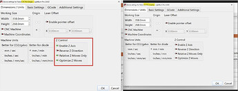

I can see you’ve enabled the Z-Axis:
They might also have had a good reason that they didn’t enable the Z-Axis in their Device Profile.
We currently know as much as you about the settings needed here.
We will need more input from the Creality Devs here.
If you can share the error you received, the steps you performed, and the file used, we might be able to get a clue, what’s going on.
Regarding the machine size, if I configure it according to the controller, it won’t let me go beyond the travel they gave me, even if I set the bed to a larger size. They should update this in the controller. They already performed an update, and it doesn’t seem to stop, although the EEPROM error persists.
I enabled the Z-axis because it had travel, as it adjusts itself. But I disabled it because they adjusted an autofocus button, and it allows it to move without having it active.

The profile they published doesn’t look “final”. You can see there some “residue” from dev machine:
"LastMachineFilePath": "C:/Users/114479/Desktop/çŸŽć›œć±•äŒšæ–‡ä»¶/L016文件",
and also as you noticed above the mismatch between firmware and profile dimensions or z axis.

And the workspace error is gone.
