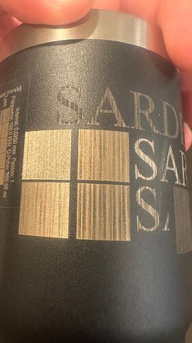

  1. Small engravings look much better.
A 20 mm × 2 mm rectangle engraved with the exact same settings is dramatically smoother than a 20 mm × 20 mm square. The banding gets progressively worse as the engraved height increases.

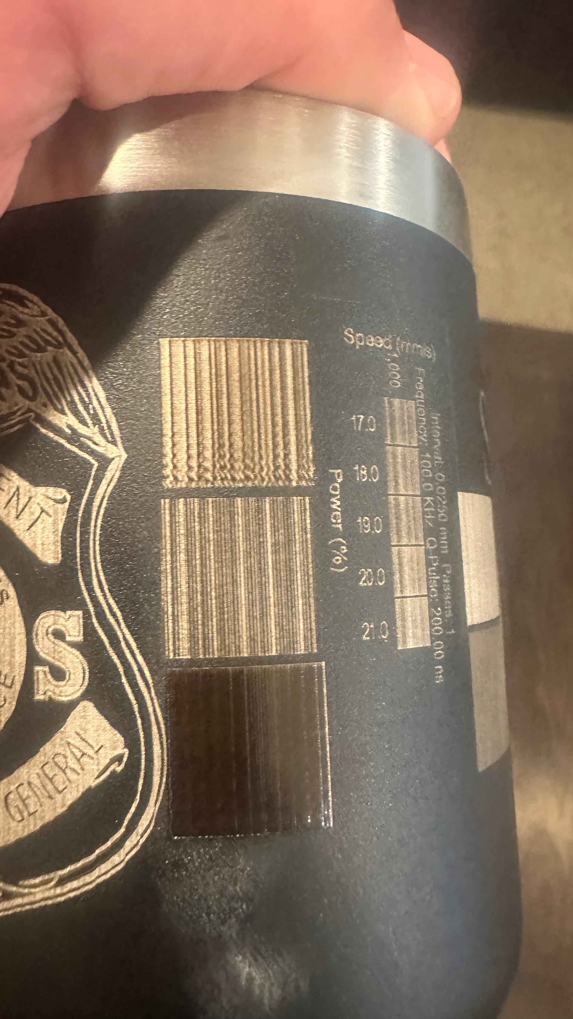

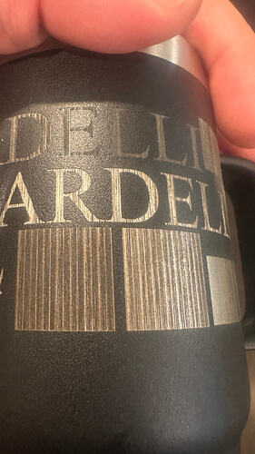

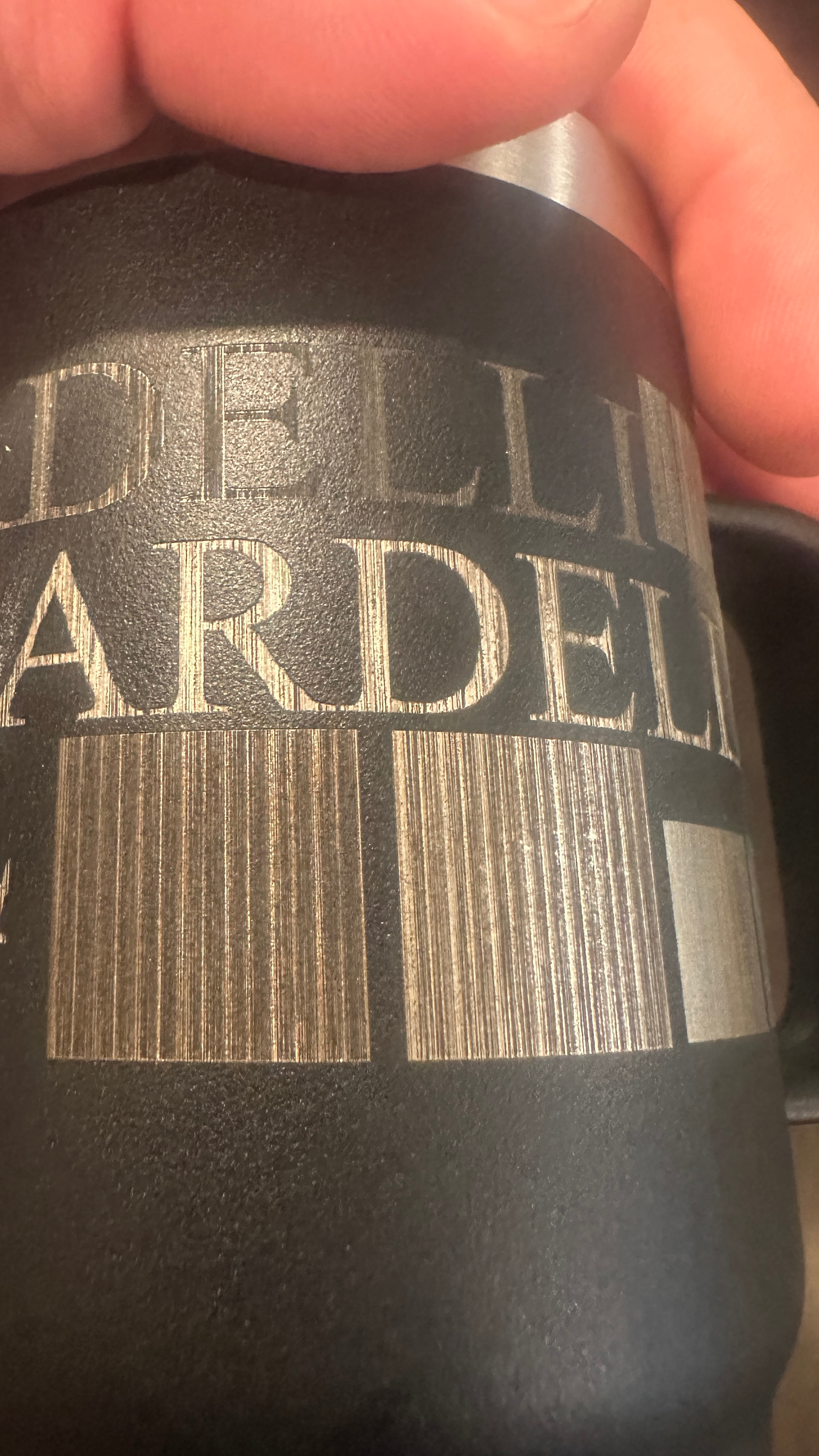

As the engraving becomes taller, very consistent horizontal bands develop.
The laser scans a strip, the rotary indexes, the laser scans another strip, and repeats. The effect almost looks cumulative.
I’ve attached photos of all my testing.

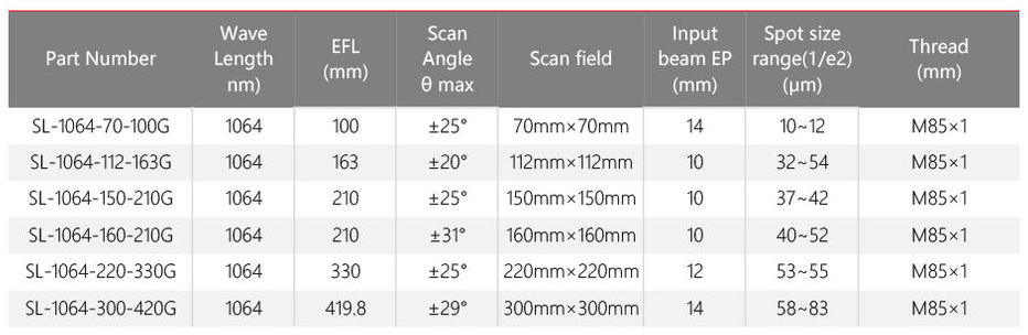

I’d like to start with how you pick your interval. I’ve pretty important with most lasers, but fibers can show strange results, especially if things don’t match up correctly.

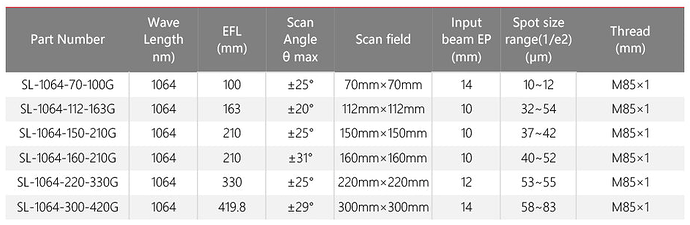

Generally speaking we use a starting interval that is very close to the machines spot size. In your case, I can’t really tell. If you are describing coverage, that’s not the same as focal length.
If you’re creating a 150mm area coverage, it’s likely you’re using an F210mm lens or nearly. As you can see, the spot size is relative to the focal length, not the coverage. Although a longer lens has more coverage but isn’t proportional enough to be used in calculations.
Going by this, your spot size is around 40 microns (0.40mm). If you scan at an interval of 0.020mm, you’re covering the same area twice. You skipped the area I though would be closest.
You machine has a range of 1kHz to 4000kHz, fixating on a single frequency or q-pulse (200ns) value, is causing you to ignore the best part of a MOPA type machine. There are only about 16 different pulse shapes.

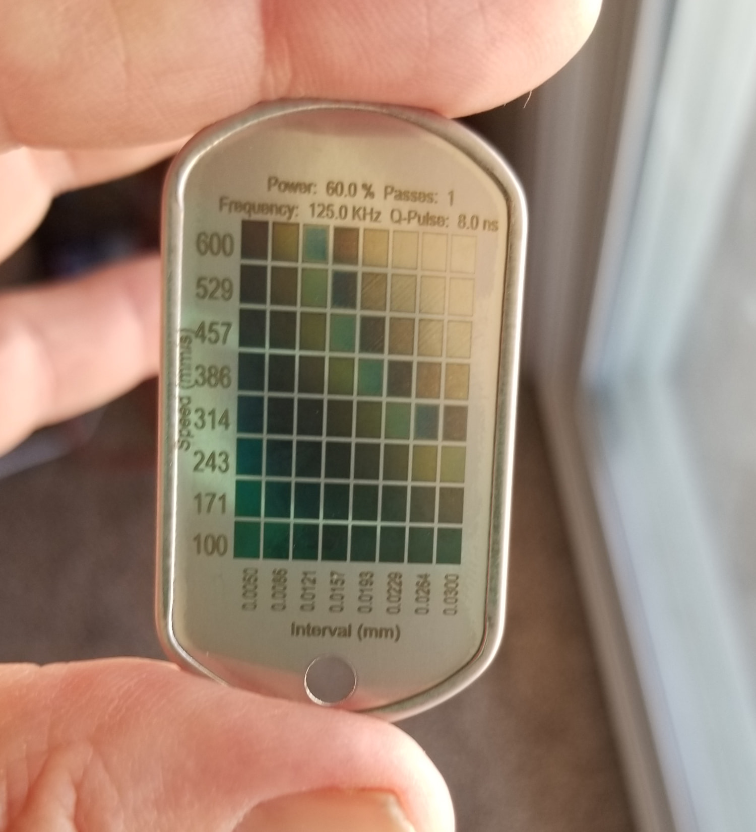

This is a stainless steel dog tag, a cheap one. I only varied the speed and interval. You can see the change in just an interval.
