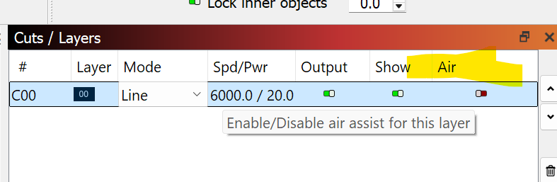

Thanks for that, i’ll give it a try. Do you know how this will affect the air assist when i switch it on in the Cuts/Layers panel? I still want to be able to use full air assist when cutting.
This switch in Lightburn does not disable low air. It only disables high air.
@NicholasL is right, it should not be turned off completely.
