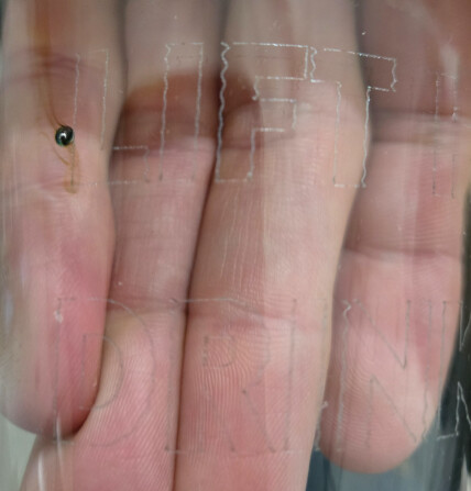

I’m new to laser engraving. I’m using an Ortur OLM3 with a 20W laser. I got a rotary Chuck to engrave on pint glasses. I’m using the cold galvanizing compound spray to engrave on it. But the lines on the letters come out shakey, jagged, not straight. This doesn’t happen when I’m using it on wood without the Chuck. Can someone help with this?
Most likely due to the material. Glass does not engrave/etch nearly as nearly as metal or wood.
Slow down the speed. There is a huge mass that you are turning on the rotary.

The wobble is from a harmonic vibration from acceleration - aka: your belts or set screws are loose or your table is not steady. Turn on overscan and set it to 10% - that will make the laser head move 10% past the end of the burn, to allow the system to dampen out the oscillations.

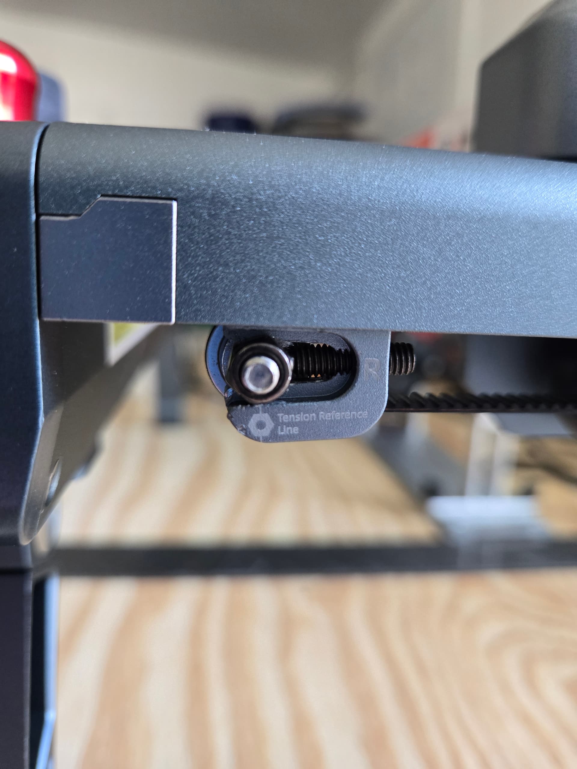

Belts and bolts need to be the right “tight” - to loose is bad and to tight is bad too.

Drop your speed to 2000mm/m and see if there is an improvement.

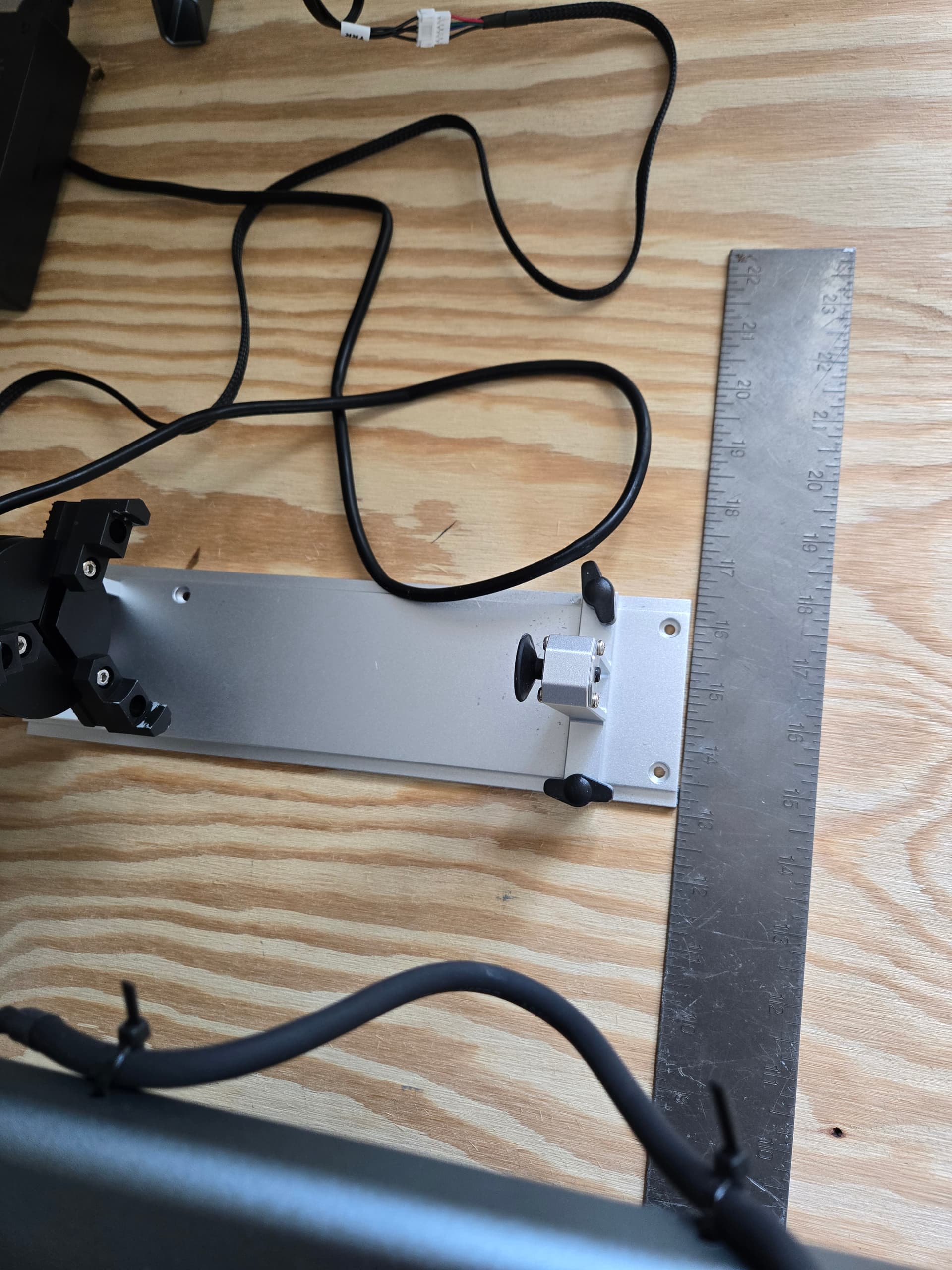

Thanks for showing me how to upload photos. I took a photo of the sides of the engraver where I had to set the tension for the belt. The bolt is exactly where it indicates it should be for the optimal tension.
The workbench is a bench I build specifically for this engraver to be placed on. It sits on a concrete foundation. It doesn’t wobble. Do you think the rotary Chuck should be screwed down into the table? There are screw holes… I didn’t see anyone on YouTube screw theirs down, but maybe I have to screw mine down?

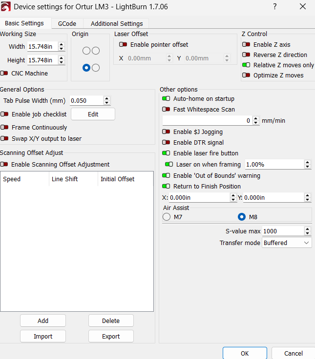

Also, How do I know what settings to use depending on the material I’m engraving? Is it just trial and error? The papers my engraver came with don’t seem to be of much use, as it says 10000mm/min for speed on glass. And the engraving didn’t go very deep on 100% power. I assume power is how strong the laser will be.
I also never found the overdrive setting you recommended.
The speedometer on my commuter car goes to 140mph, short of being dropped out of an airplane that car is never gonna see 100mph, much less 140mph.
The max speed that the software controller can handle is 10,000 mm/m, but the laws of motion and the limitations of the hardware will not support the sales brochure.

Expanding on this, 10000mm/m is stunningly fast for a rotary. The inertia of the glass will surely cause slip.
It will not be very deep. You will only, and should only, fracture the surface to get the frosted effect. Too much heat will fracture the glass. I have a 2-part shot glass to prove it.
You did not mention any surface coating. A diode laser cannot etch glass without it. Your results can vary a lot depending on what coating you use.

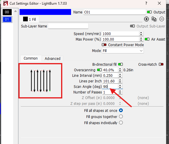

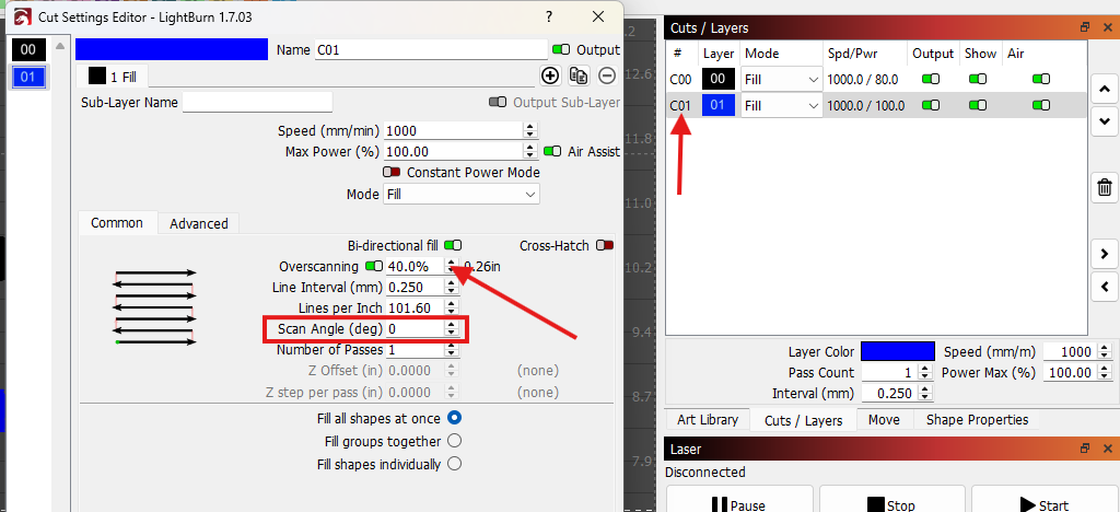

Here’s a link to video I thought I’d share to help explain the overscanning that James mentioned.
LightBurn has a variety of helpful videos on YouTube.

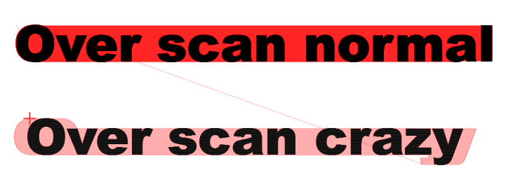

Same speed for both text lines. Overscan makes the laser head travel past the end of the burn. The ovescan can cause issues if it crosses the work area boundary - i.e. makes the laser head run into the side of the frame.
Double click on the layer in the CUTS/LAYERS window to open layers settings
Notice the OVERSAN setting - normal is 2.5%
Scan angle is where you change from X to Y as your primary axis. 00 is flat on X axis, 90 is straight up and down on Y axis.

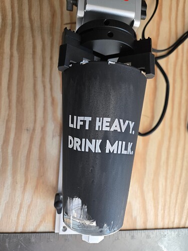

P. S. Slowing the speed to 2000mm/min worked well! No more shakey lines, but my text is coming out wavy and smooshed. So I fixed one problem, and created another…
Is the tail of the tumbler supported by rollers? That is a lot of overhang for the plastic chuck jaws to hold tight.
This amount of overscan is not crazy, that is pretty normal. especially if you are using a co2.

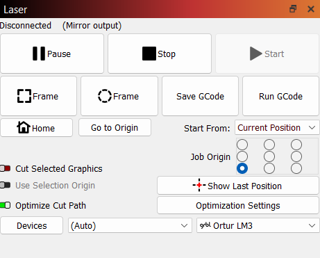

I would like you to turn the glass around if you can. When you frame the job, does the glass rotate in one orientation - i.e. does it wobble? The heavy end should be the part in the chuck jaws.
Does you laser head go from top to bottom of the glass, or does the glass rotate back and forth?
It rotates back and forth when I frame the job. doesn’t appear to wobble to me. when I frame, it goes from top to bottom to top again.
Noted that the bottom of the glass should be the end in the chuck jaws.
True about the CO2 - was using a diode as an example of 2.5% vs 40% on the same laser at the same speed and power. Not trying to get lost in the variables with too many details.
