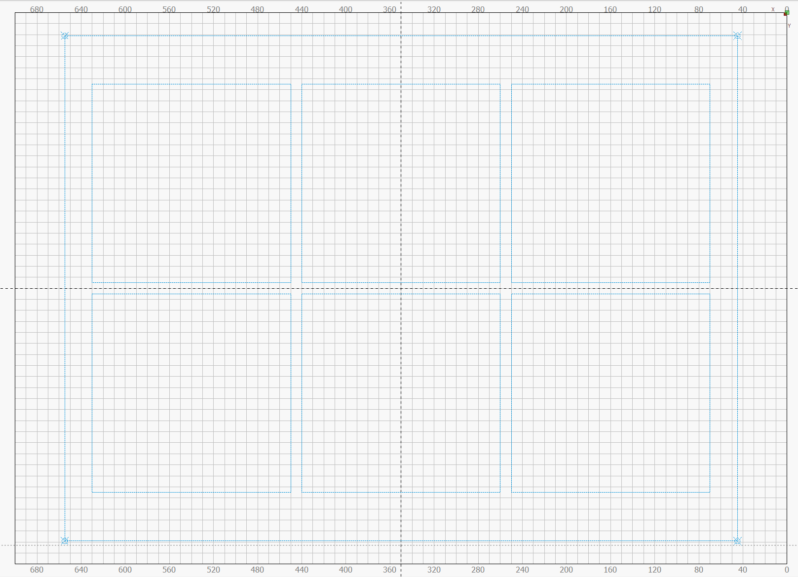

I made a template for a layered-paper arrangement with six panels:
I built that from a single square in the middle, moved into the lower-left place with Numeric Edits values, then produced the other five at their places with a Grid Array.

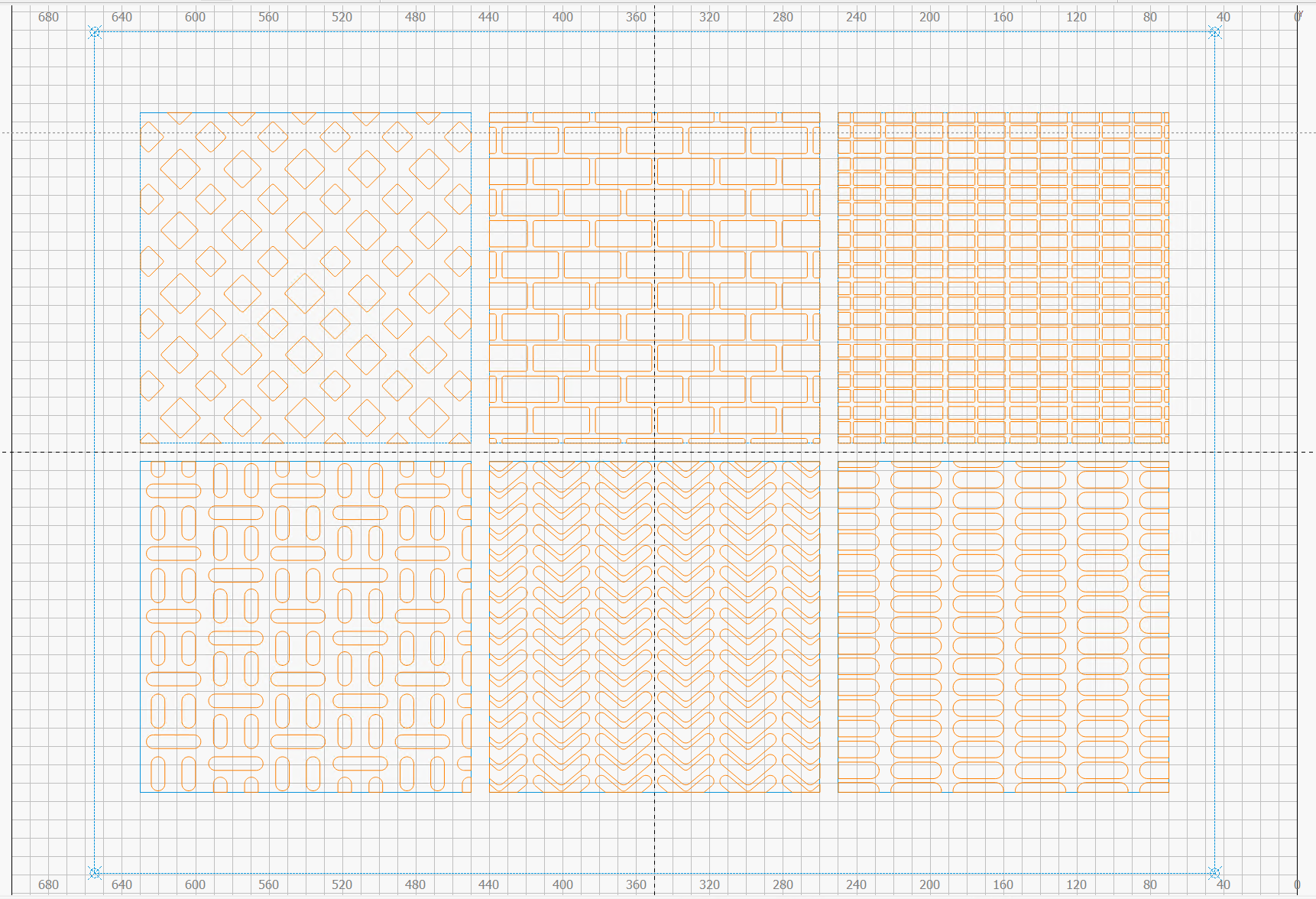

Then I can drag-and-drop the patterns into the template squares by their centers:
After getting the template set up, there’s no fussing with offsets: the patterns snap to the center of the squares.

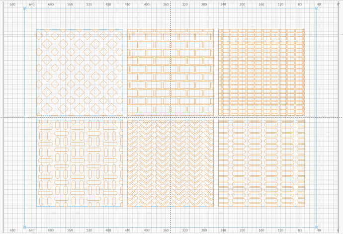

The larger rectangle around all the patterns lets me plunk the whole thing into the center of the platform by selecting everything and tapping P, with no dragging required.
A further cheat:
- Make four duplicates of the template, one for each paper sheet
- Arrange six panels for a sheet in a template
- Arrange four templates around the workspace
Then for production:
- Select a template and its panels
- Duplicate to make a copy
- Hit
Pto plunk it on the platform - Fire The Laser!
