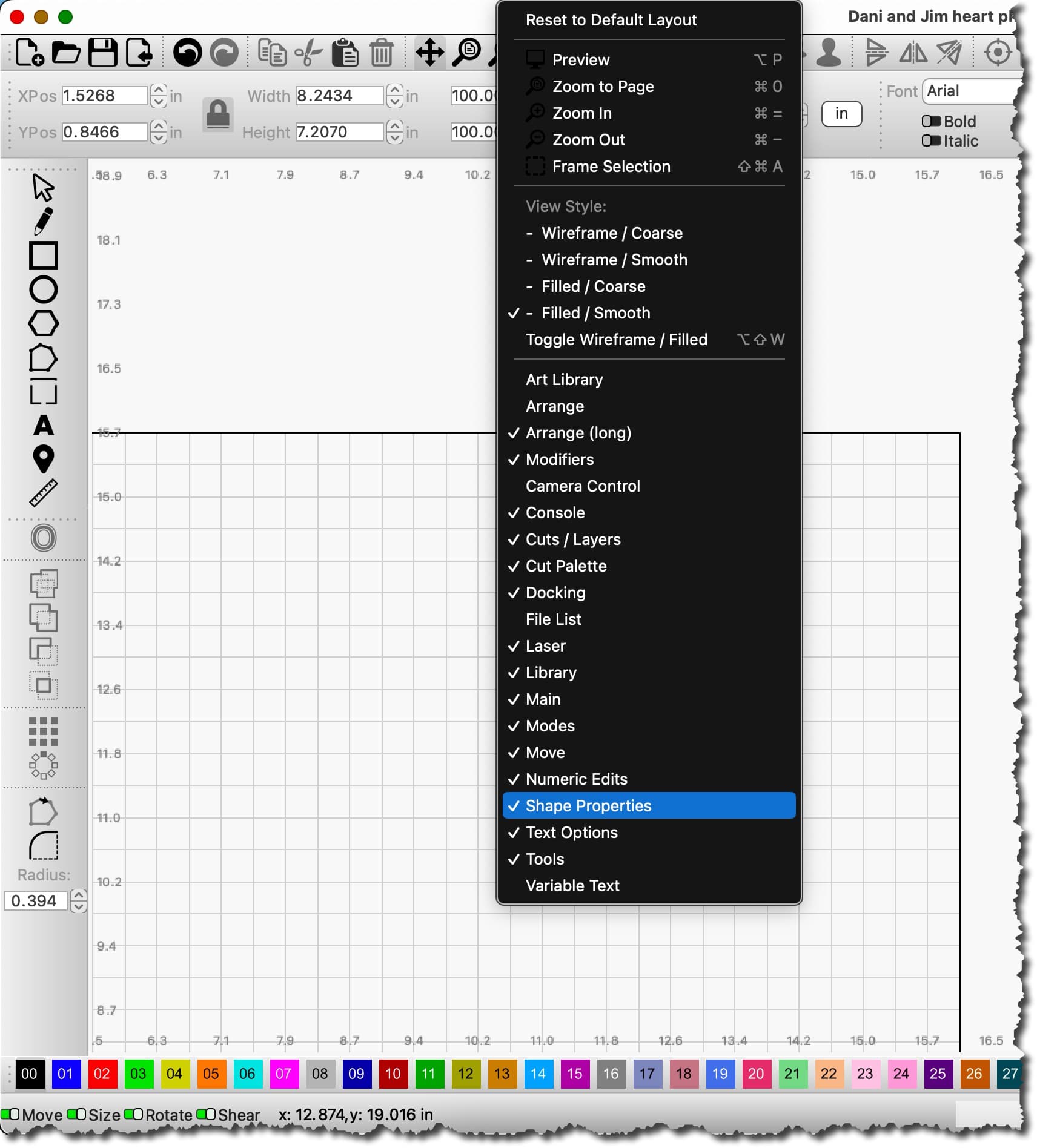

The box is there, but there is nothing in it. Usually it has the start and stop buttons, the speed and power settings for the individual colors, etc. None of those are showing up so I cannot run any of my patterns.
If I am understanding, that would be the ‘Cuts / Layers’ window. Is that window turned on? :slight_smile:
You’re describing the contents of different windows.
Can you provide a screen shot please?
