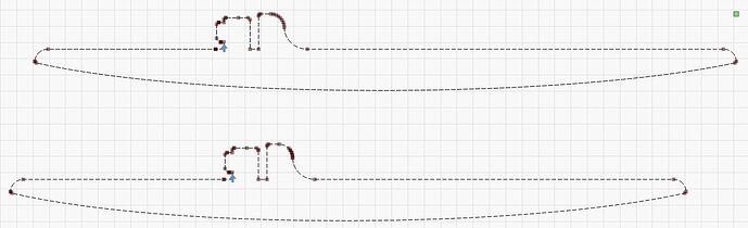

Hey guys. I went to run a job today and for some reason the Shape Start Points that I set are not being used. I ran some jobs last week where I set the start points and they worked fine. I have no idea why they just stopped being recognized.
I will mention that the shapes are not grouped. I have tried every setting in the Optimization Settings dialog and nothing helps.

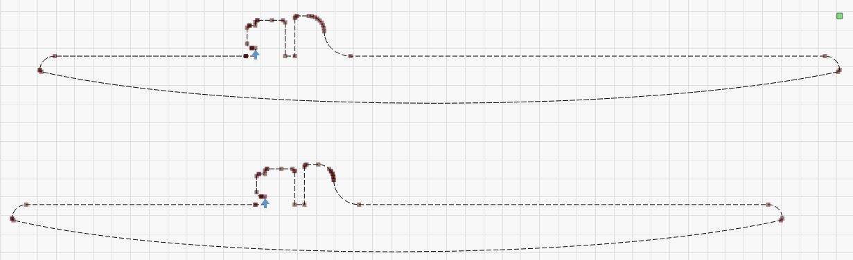

You can see in the photos that the arrows are set but in the preview window they are ignored. And yes the laser follows the same path as the Preview window.
What is interesting is if I open one of the files I ran last week (that the start points were working in) and Preview it, the start points are still working.
I have tried creating shapes in LB and testing the start points as well as importing vectors from Inkscape. If I create shapes in LB the start points seem to work. When I import from Inkscape they do not work. BUT the files that worked last week were imported from Inkscape so I am completely at a loss.

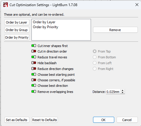

You might check out the optimization settings, especially the “choose…” options:
Yeah I tried all of those options and nothing changes.
Thanks for the suggestion.

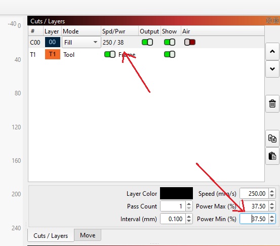

One user is reporting the speed settings aren’t being acted upon, i.e. he inputs a speed setting, but his machine runs at a different speed. For me, it’s the power settings that aren’t being handled correctly (see picture). I’ve only updated my design PC (it’s not connected to a laser) so I’m not sure how the laser will respond to the differences between the two settings. I’m going to run the job tomorrow and see what happens. Just thought you might be having problems with the new version.
Interesting that you mention that. I noticed last week that my speeds do not seem to be going as fast as they used to at the given speeds. I thought it was just me, but maybe something is off. BUT I have been running 1.4 since it came out so I am not sure how that could change. Although the Shape Start Point always worked before too so :thinking:
In the case I mentioned, his laser was going much faster than was programmed. I’ve been running LightBurn since 1.0.01 and have been renewing it ever since. I got lucky a while back and participated in an online interview with a third party reviewer (it was after their convention), and I talked about my LightBurn experience. For my time, I got a couple years of free renewals. I don’t know how I got picked, but I’m glad I did.
