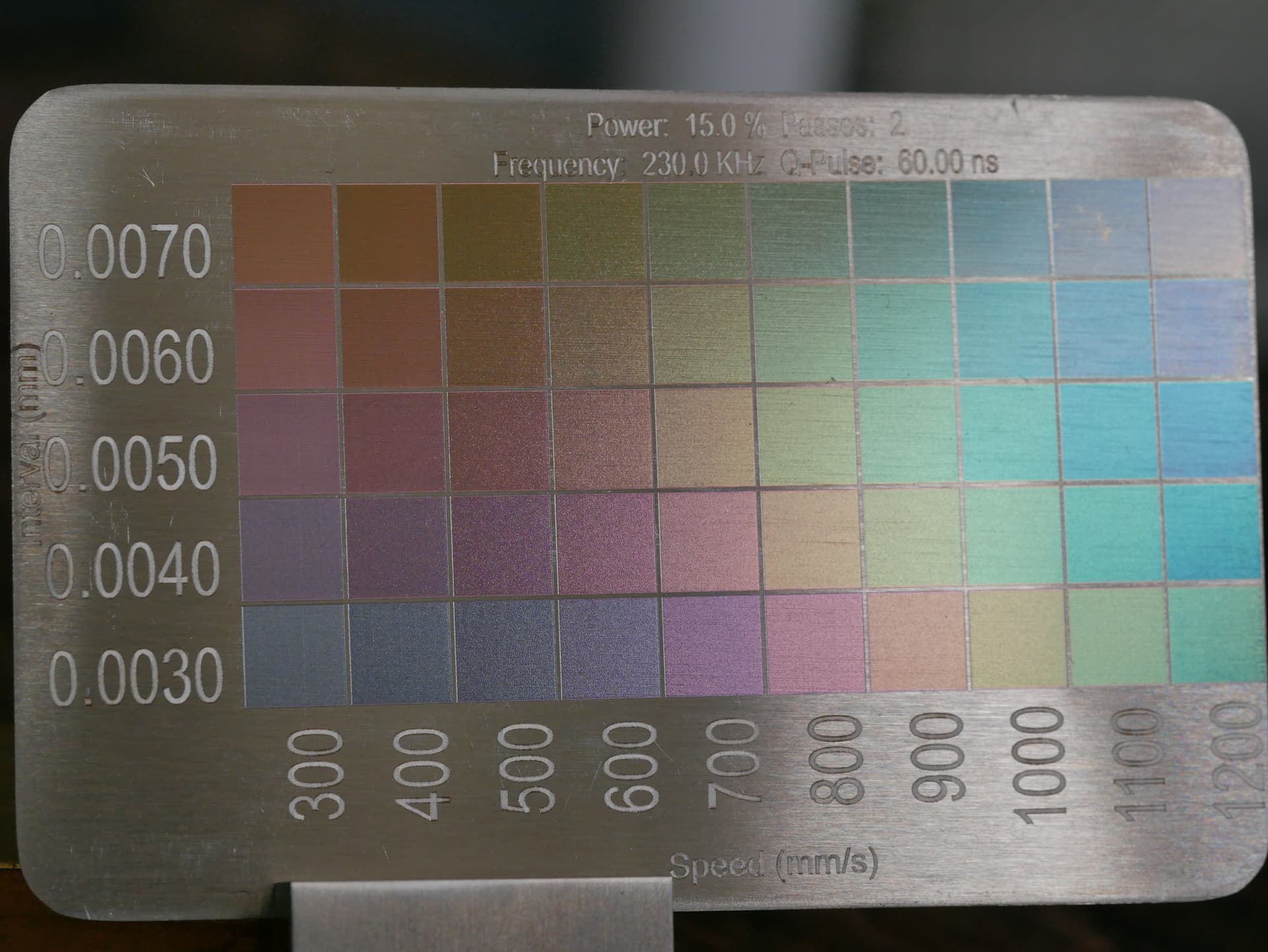

Hi, here is a gallery of some material test plates I’ve done trying to find good colors for 304 grade stainless steel. Obviously the colors do not look the same from every angle, so I’ve tried to take the photos of them looking their best under natural light. I’ve tested these colors to be stable-ish - they look relatively the same on differently polished surfaces and at different sizes. Of course your mileage may vary as this is not an exact science.
The tests were done using a MOPA JPT M7 60W laser with a F290 200x200mm lens. The hatches for all of these are bi-directional, if multiple passes are used then increment angle is 90°.
Sample of some tests, you can find all ~30 of them in the gallery linked at the start of the post:

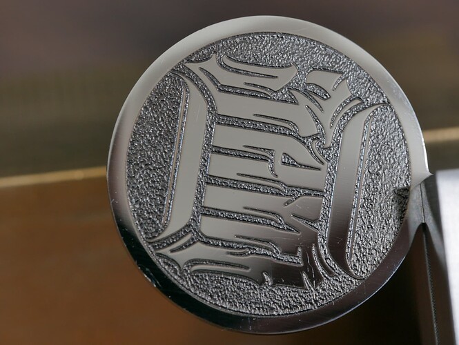

Bonus - consistent rough textured black:
First layer:
275mm/s, 80%, 350khz, 200ns, 0.02mm bi-directional hatch.
Second layer:
300mm/s, 23%, 110khz, 200ns, 0.002mm bi-directional hatch.
Only works on thicker material, it will burn/warp steel thinner than 1mm.
If willing, please explain the process you take to produce this ‘stippling’ texture. Is it produced using just settings, or is this stippling done using an image? :slight_smile:
Just the settings, I wanted to find a natural texture without resorting to an image. I did quite a lot of testing to find settings that would consistently do that, found multiple ways but this one is the most consistent so far. The first pass creates the rough texture, the second pass is the black “anneal” setting which I found on the internet. You can do a cleaning pass and some other color pass after the first one and get the same rough colored texture, but not all colors will work with it.

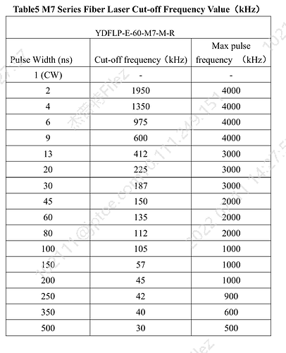

Is there a specific reason for this or am I misinterpreting something? It appears to me, you’re running outside of the threshold frequency? I think we have the same source.
With a 60nS q-pulse the fastest pulse rate (frequency) is 110kHz, you’re running 230kHz?
A 200 nS q-pulse requires a frequency of 40kHz or lower, yours is 110kHz and 350kHz?
Maybe it’s me… maybe need a nap?
But not at full power. This is a chart for the max frequency you can achieve at full power. You can run it at higher frequencies with lower power. Here’s another chart which shows what max pulse frequency you can achieve:

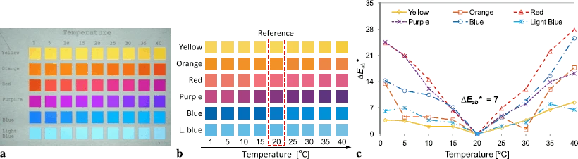

Environment temperature does not have extreme influence, at least not for most colors, you can see that in this figure from this paper on titanium coloring.
As the figure shows 40 C variation barely influences most colors. I’ve did some tests on my own by using an adjustable heating pad to raise the temperatures of the metal to >60 C before engraving and the variations were barely perceptible.
In the end you are gonna have to suck up the costs and do tests when working with this. :grinning_face:

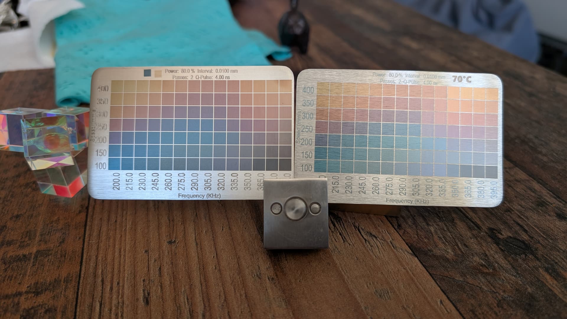

To demonstrate what I’m saying I’ve decided to do some tests. I’ve again engraved two material tests I’ve already done at around 18°C, only this time on a heating pad at 70°C. Here’s the setup, the temperature on the pad was set to 60, but the temperature sensor inside is not very accurate and it does heating cycles by heating itself to about +10 degrees it is set to, then stops heating for a while and repeats the cycle. I’ve measured the temperature using an accurate thermometer before starting to engrave, so the ambient temperature of the steel card was around 70°C during the whole engraving.
And here are the results, there are differences, but I would say they are minimal considering the 50°C difference.
