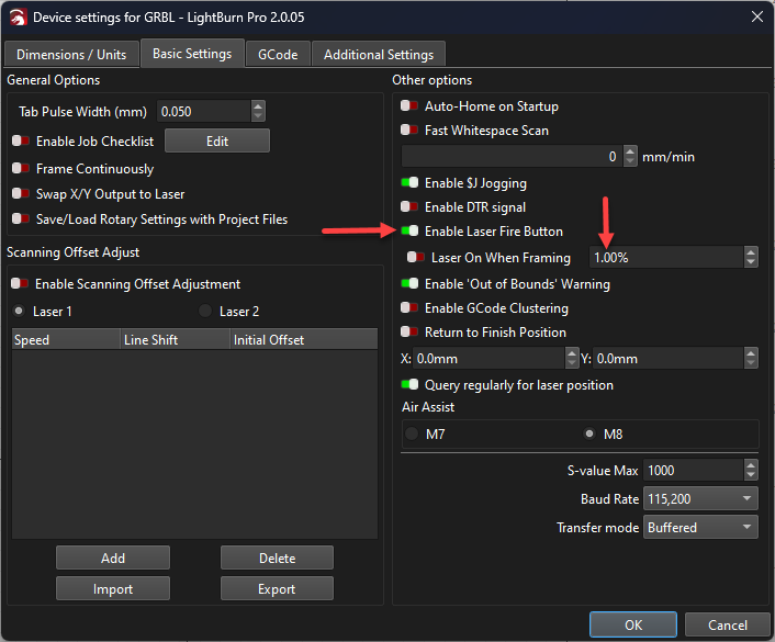

Hi everyone, I’m new to lasers. I bought a mini laser (Pixi Algolaser) to get started. I’m having a bit of trouble framing. I press Shift + Frame, and the laser moves but doesn’t light. What could be wrong, because I can’t find the answer. Regards
You must also;
-Enable Laser Fire Button
-Enter a power value to use when framing
