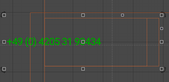

Also, I have to copy a text, resize it, assign the right font, and sometimes adjust line breaks manually. It would be way easier to define a rectangle for the text, where the text will automatically fill all the available space and get smaller, if necessary. But I assume this can’t be accomplished?

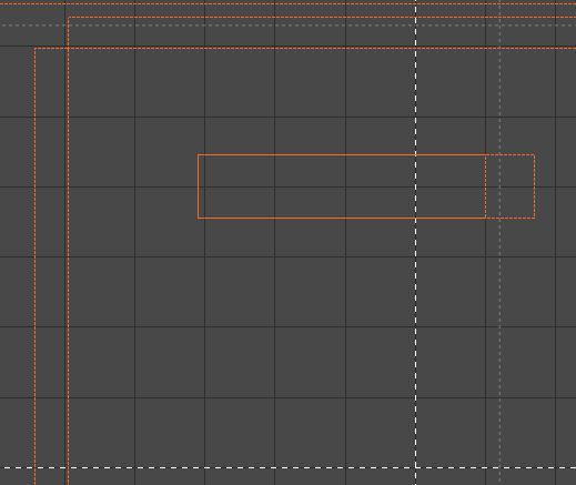

Docking doesn’t work inside a rectangle, but if you’re willing / able to put a pair of rectangles outside the boundaries, the Docking tools will do what you want:

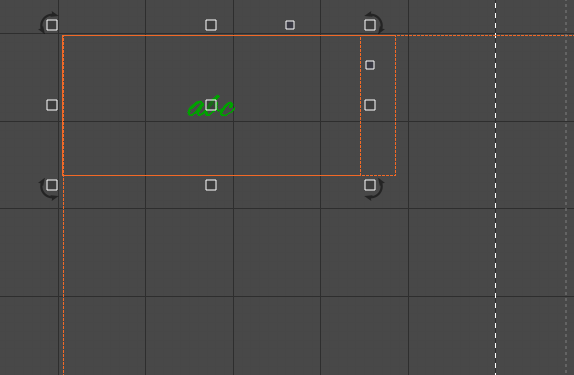

The Squeeze option will work when you’re importing text from a CSV file, which is suitable when pouring different many different text snippets into the same container.
However, it seems like you are massaging each chunk of text in unique ways, which is definitely not LightBurn’s strong suit. If you can do all that in a program better suited to text wrangling, then export the results into LightBurn, it may produce more net happiness.

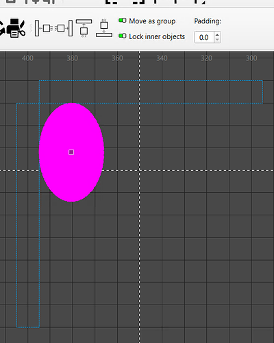

Docking doesn’t work against the inside of a rectangle, so you can’t just plunk the imported rectangle+shapes inside a larger rectangle and dock it against the sides.
So you need two rectangles at the template cornder (one for X, one for Y) and you must dock the imported rectangle+shapes against both of them in succession.
After you have the template set up, docking into the corner requires two clicks instead of one, which seems survivable. :grin:

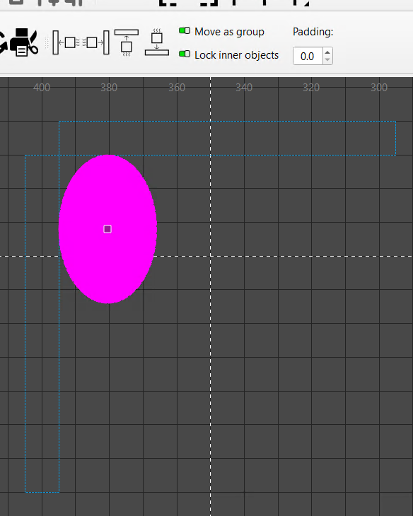

I haven’t really figured out what you mean. I have 2 corner objects, but what do I do to place my object in the corner?
Make sure the Docking Tools are displayed:
With that done:
  • Select the object
  • Click the Dock left tool icon (on the left)
  • Click the Dock up tool icon (third from left)
You want no padding, so set that field to zero.
When you have something with more structure than a rectangle, you probably want the two switches turned on so the whole affair moves as one lump.
Put the two corner rectangles on a tool layer so they don’t end up getting scorched into the material.
Thanks, it kinda works, but if the selecting has inner text, it gets moved way to far.
Enable the lock Inner Objects toggle
thanks, at first it seemed like weird behaviour but now it seems to work.
