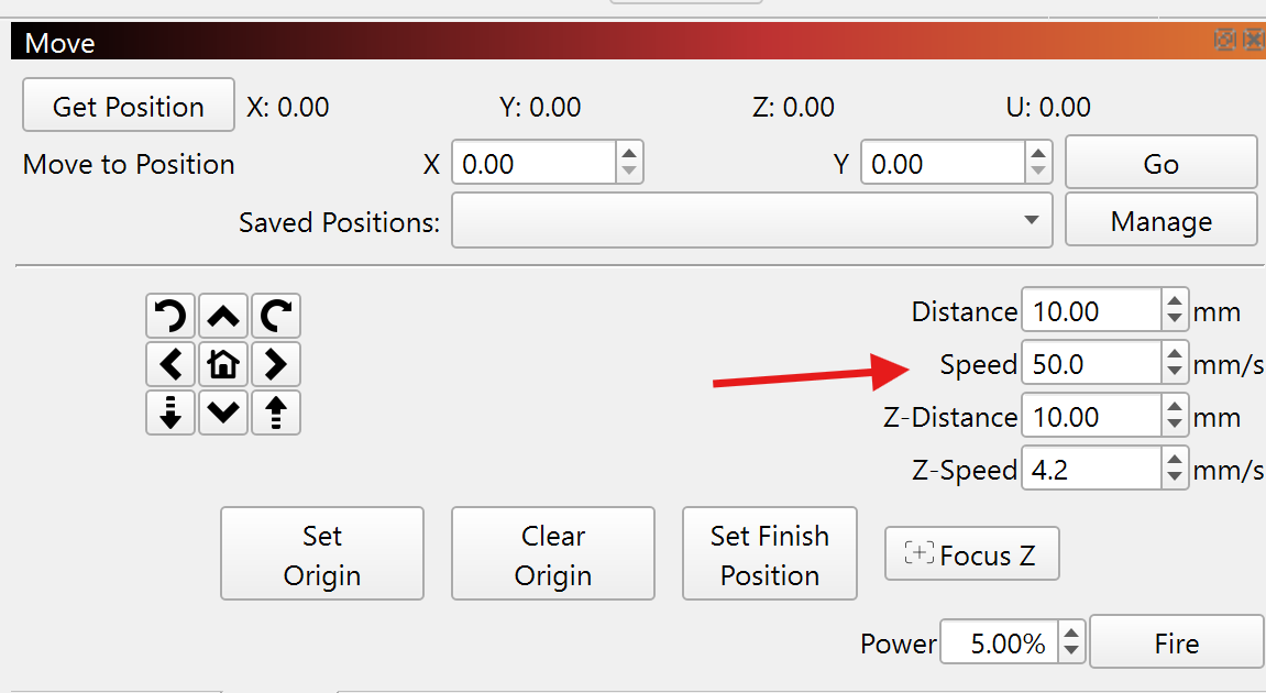

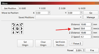

Yes. “Frame Continuously” is currently not available when using Custom GCode. We have an internal task to add this.
The speed of the framing is taken from the “Speed” inpout in the Move panel here:
Slowing it down should make it easier to see the trace, but you’ll need to press Frame again if you missed it.
Hopefully, the videos you mentioned will explain this part.
You can upload videos to YouTube, or WeTransfer and paste a link here.

I changed the framing speed on the MOVE window, but there were no changes on the actual framing.

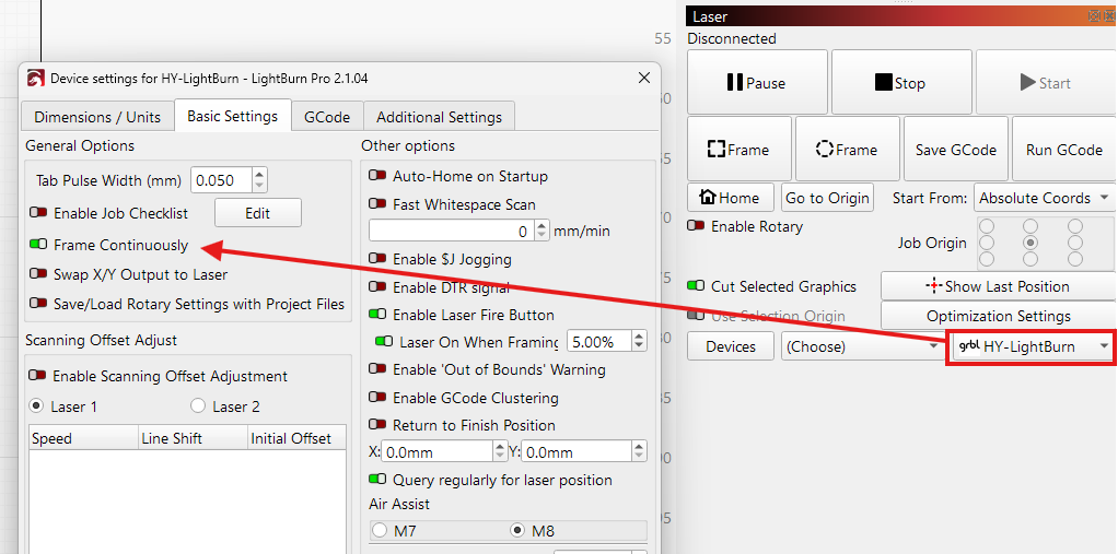

I made another video with 1.7.00RC2 and 2.1.04CustomGcode. Here is the link. Thanks.
In the videos, the Start From option was set to “Current Position”:
This won’t work on a GRBL based galvo. Always use “Absolute Coords” here.
We have plans to create a dedicated device type for GRBL based galvos like yours to accomodate this and have it set to always use absolute.
The “Framing” window showed up in the 1.7.00 RC-2, because you were using the “GRBL” device type with “Continous Framing” enabled. That’s the the option that’s currently missing from the other Custom GCode Device profile. (We have a task to add this).
