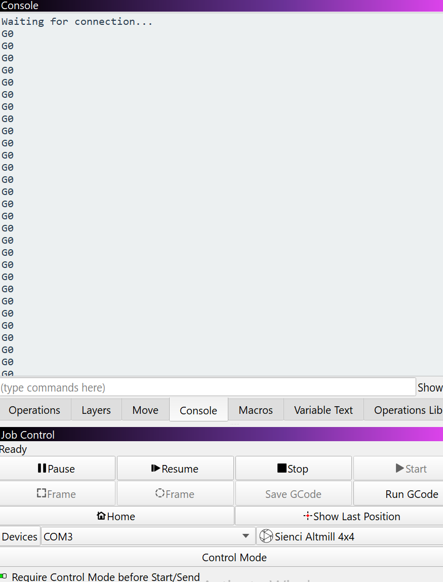

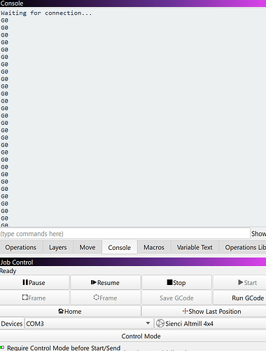

Please enable “Show All” in the Console window, and send us a screenshot if you receive any errors.
Here you go…

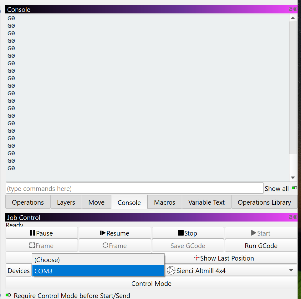

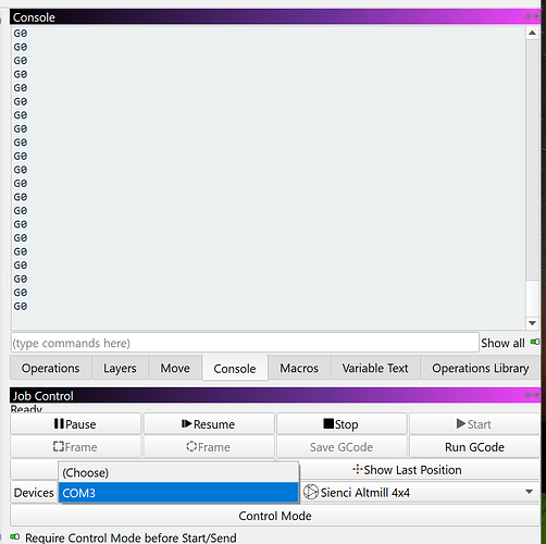

Can you see an alternative port to connect to, next to the Devices button? The Altmill has 2 ports available - only one works for controlling the machine.
the G0 is MillMage sending a ‘hey, are you there?’ and not seeing a reply
No I don’t have an alternate com port. COM3 is the port that I use when connecting with the Sienci provided gsender software.

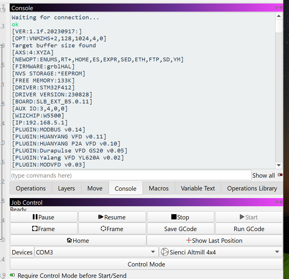

After checking the estop, I loaded Gsender, connected to the Altmill, then pressed the unlock button on Gsender. Closed Gsender, started Millmage, and I immediately saw a stream of data in the console from the Altmill controller. Was at that point able to home the machine.
So something is not unlocking the Altmill controller when I first connect with Millmage. Any ideas?
Here you can see some of the console data as I mentioned.
