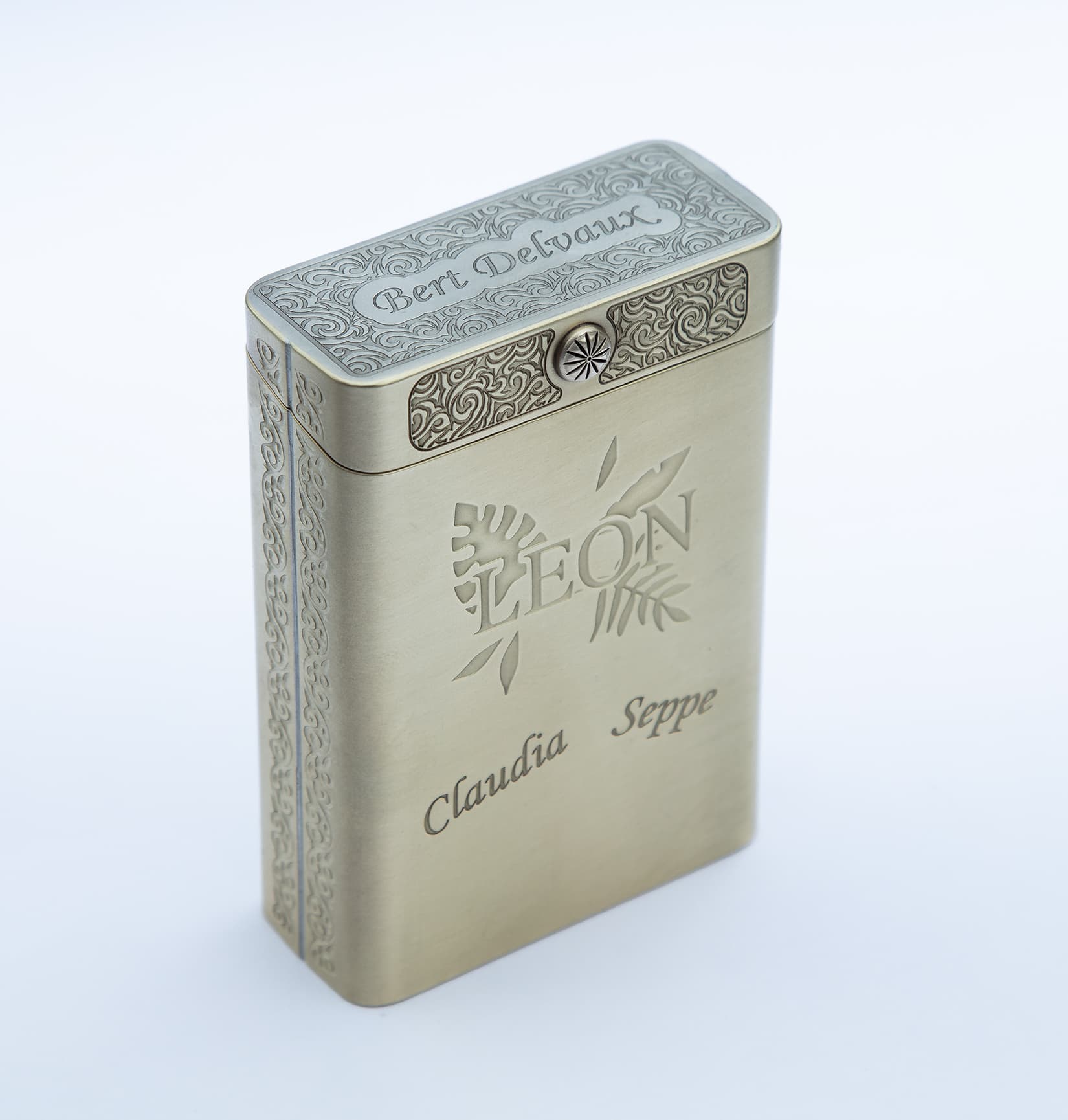

A custom fiber laser engraved sigarette case as a present for a soon to be godfather. The box for 20 sigarettes is selfmade from 0.5mm thick nickel silver sheet and tin soldered together.On top the name of the godfather…on the front the name of the baby…lower the names of his wife and son. Extra room below for more names if needed. There’s a small neodymium magnet inside to keep the hinged lid closed…

Super impressed that you actually made the case itself, and it looks like a tiny rolled edge at the lip of the opening - how did you do that? are those edges folded back on themselves?
@HoutmeyersP , that looks really nice! Did you cut the case parts with your laser or by hand? Did you do the engraving after the case was assembled or when the parts were flat? Maybe you could describe your process?

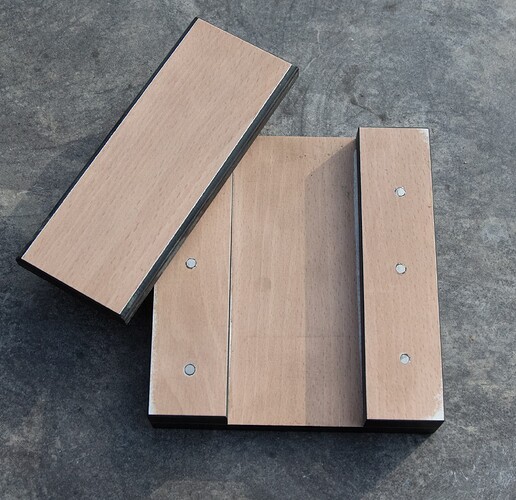

The cutting of the parts was done by hand…if you would cut them by laser chances are the thin sheet wil warp unless you are using an expensive clamp to stretch the sheet flat during cutting…i do not have that clamp. All engraving were done after soldering. I used a aluminium block to insert in the box as a heat sink…so most heat while laser engraving gets absorbed into the alu block and the thin sheet metal will not deform. To further prevent any heat build up i did all engravings using the laser in multiple 10 passes steps…leaving the case to aircool between steps. To bend the 2 halves of the box i used a jig made from scrap hpl panel( photo below)…the opening between the 2 sides is 1mm wider than the insert leaving 0.5mm space at both sides to allow the sheet metal to fit into. I put the sheat on the jig and center the form piece( with rounded of corners) on top…then used a heavy bench vice to push the forming piece into the lower part of the jig. At one side of the box i added a overlapping/recessed edge to get a wider solder seam.
Hi. There’s no extra rolled edge allthough it lookes like that , i only used a red scotchbrite wheel in a drillpress to soften all the sharp edges on the box. The outside finish is also done with an even finer grey scotchbrite wheel to remove small scratches and give an overall uniform look , also preventing the box to shine like a mirror. You cannot keep a mirrorfinish clean for very long. Thanks for your interest :slight_smile:

I love perfection and you have achieved exactly that. Congratulations to you and all.
