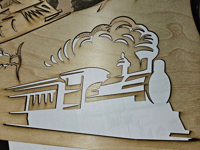

I am trying to cut out complex shapes on a sign board and want to keep the profile and inner details. For example, a cactus and not have everything fall out and only leave the outline.

Thank you for your response. I have tried tabs and did not achieve the result I wanted.

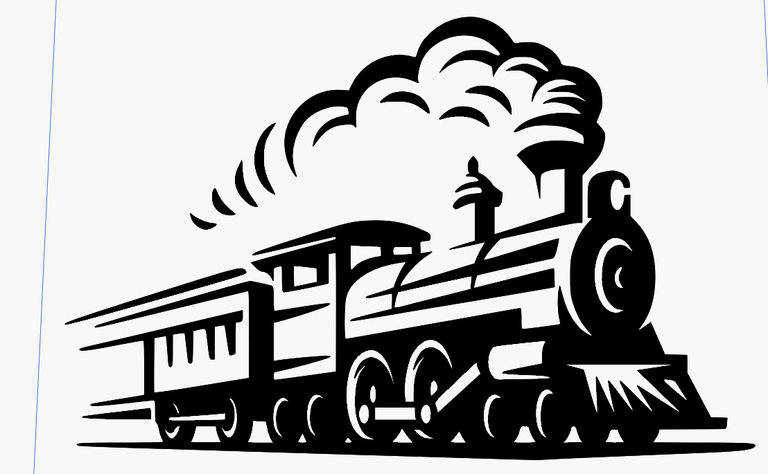

Below is what I am working on at the moment. A train silhouette as shown in the in the “ai” tab. What I am getting is shown in the other 3 photos.
I have tried putting a wedge through the train at several points and then welded it but that did not work either.
Your thoughts would be GREATLY appreciated.

You will need to manually create bridges of some sort. Something like this.
At a minimum, all the parts I have marked will need to be joined to the surrounding area in order to not fall out.
The way I tell what will fall out and what will stay is to put it in fill mode, then I can see that anything black will fall out, anything white that is totally surrounded by black will also fall out and needs to have some kind of bridge to nearby white area.
I think this image will lose much of it’s integrity if you create all the necessary bridges. It’s probably better suited for engraving rather than cutout.
