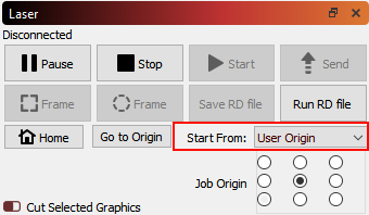

Hey All, I Have a silly question, im enabling save job origin to project and its working great, but my question is, if I have multiple jigs and they all have different job origins, do I have to redo my origin every time I swap projects? I hope I explained and or asked that correctly. ideally I want to be able to run a production with one jig then when I swap to another project with a different jig I want it to remember that ones origin as well
If I understood correctly, this won’t work. Saving the origin does not save a user origin that you set somewhere in your workspace. This ONLY stores the origin setting (not the actual position) that is used here:
(At least that is how I understand the docs) So if you need a different (user) origin each time, this is not stored in that file. It only stores that you want to use a user origin or current position or anything.
If you have multiple jigs and initial positions, I’d use absolute coordinates and then store as many positions you need in move window. There you can select a position from the dropdown-menu and the laser will move there.
