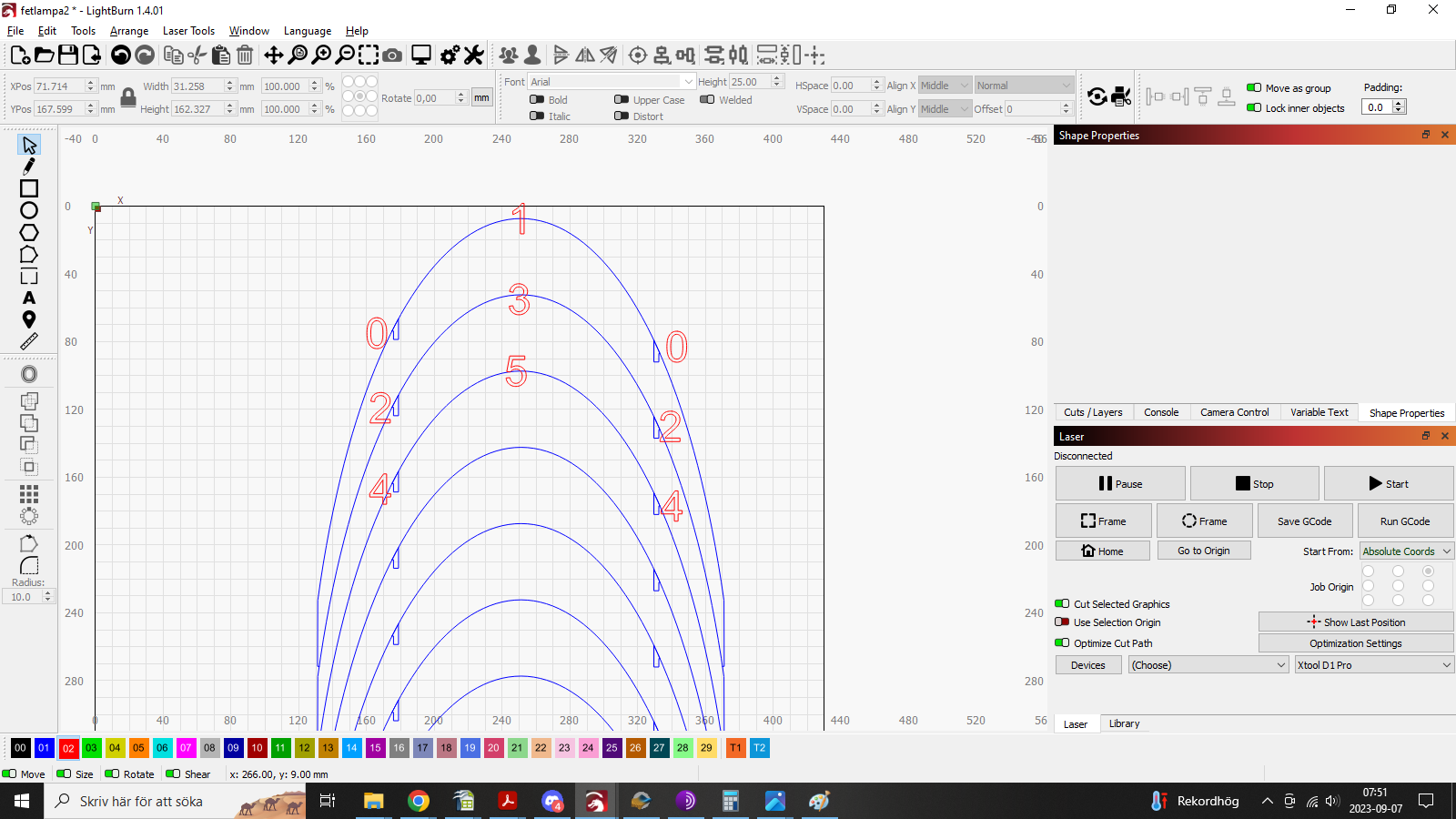

I would like a hotkey for setting the cut order priority in shape properties, to the next unused order. For example if there are no priority orders and all are set to to 0. I click on a shape and then the hotkey that shape would get cut priority 1. If then click on another shape and the hotkey, it will get cut priority 2, and so on.
The background is that I cant get it to cut in the specific order I want using the optimization settings. And for my current job I need to set about 40 cut orders and that would be a lot of time saved with this hotkey.

I’m not on my computer so I can’t show the file. But the issue is the time it take to click och each object, move the mouse to the cut order box, type the number(and keep track on what number I’m on), move the mouse back and click the next object and repeat. If I can just click on the object and then the hotkey, next object, hotkey - it would go much faster.
I can make it cut in the right order with layers but it will be a lot of layers. Doesn’t feel right but maybe it’s fast enough. Will try.
Best would the using optimization but I just can’t get it to do the order I want it. I will get back when I have time with the computer again…

This one is tough because the whole project is on one Line layer.
This layer is then set to engrave four passes.
LightBurn engraves each line 4 times before moving to the next line or feature.
What is the specific order you want for this project?
Four passes at 100% looks like a cutting operation.
This is the order I want on this project. I did up to 5 but its repeating itself so you get the point. Preferably I also want to be able to rotate it 180 degree and still cut it from top to bottom. So a optimization order would be best but a fast way to set the cut order would work.
Also, I have created this with the array tool. If I set the cut order in shape properties for the object that I multiply, it could have an option to raise the cut order with the multiplied objects. For example I have 3 cut order in that object, 0, 1 and 2. And if I would make an array of 10 objects, the second object would get cut order 3, 4 and 5, and so on… that would really help this particular project but I think a hotkey to set cut order would be more versatile.
I see what you’re saying. I can force the cut order you want by using layers and sublayers but there’s no optimization path that follows the proposed order.
This is an intriguing idea. Please post the feature request to the Fider site and up-vote other feature suggestions that are of interest.
