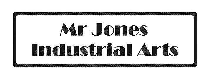

Really important distinction between a RASTER image (.jpeg,.png etc) and a VECTOR object. As mentioned above, images are the hardest thing for me to produce. Vector objects are where you need to start when you are importing items.
Basic shapes can be manipulated very easily in Lightburn. In my experience, people love to be able to customize their items. You may consider getting some light plywood and having them make a name plate or wall hanger with a name, saying or logo. What age level are you instructing? I presume High School.
EYE PROTECTION will be your biggest concern in the classroom. Most value lasers will ship with a dark green eye protection - which is the wrong wavelength for diode lasers. Their light is a brilliant blue/purple. You need red/orange glasses rated to filter the wavelength of your laser (~400-500nm)
Fume extraction will be your second biggest issue.
This is a 30 second build. It could be a full hour instruction for new users.
