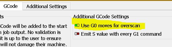

You could try this options first.
Confirm if the G0 speeds get set at F6000 after the G1 or stay at F15000.
I don’t know if Xtool keeps both speeds (from G0 and G1) or if it only takes the last one used.
You could draw 2 separate squares and run at 300mm/m 1% power add G0 F15000 to the GCode just to test speeds.
Check your Y axis max speed, If it works add G0 Fxxxxx (Y max speed) then check engraving precision.
