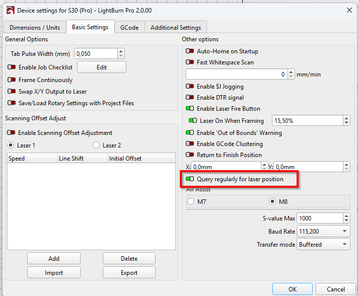

Since 2.0 install console is constantly scrolling while idle
LightBurn Software Questions
misken
(Melvin)
July 13, 2025, 5:32am
4
Then check this:
This is more likely the cause then.
