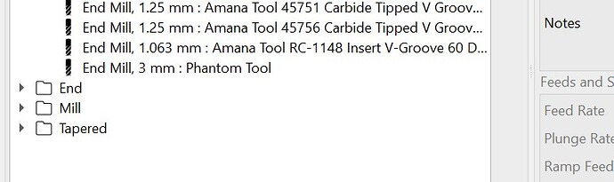

What is your screen resolution? Can you just show a screen shot of the entire desktop? (Windows key + Shift + S)
THANK YOU ESMES!!!
