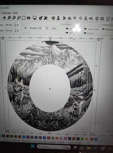

Since I ran the update two days ago I can’t get my laser to engrave any designs correctly. I first thought I had bad files and reached out to designer but found it happening with old files I used before as well as files from other sources.

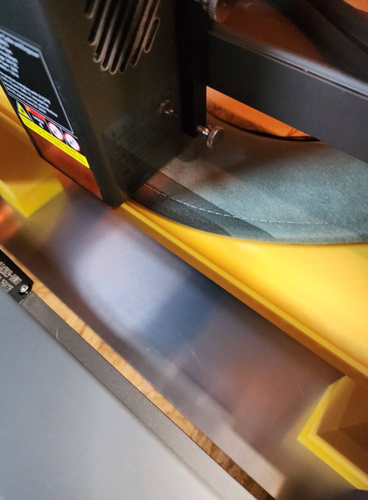

I engrave designs on hats. I do hand burning but use laser from the more substantial and detailed designs.
When I import a file into Lightburn the preview shows almost a completely black final product in all images modes except grayscale. So I went with grayscale but it still burned solid. I don’t know how to fix this! I have tried redownloading file and got same result. I turned everything off and started over with same result. I tried going back to old version and still getting same result. I made sure my laptop was up to date with all updates. i uninstalled lightburn and reinstalled. No change.
You will see different colors on the engraved part of the hat because I have used the same hat to check the different settings since it is already ruined.

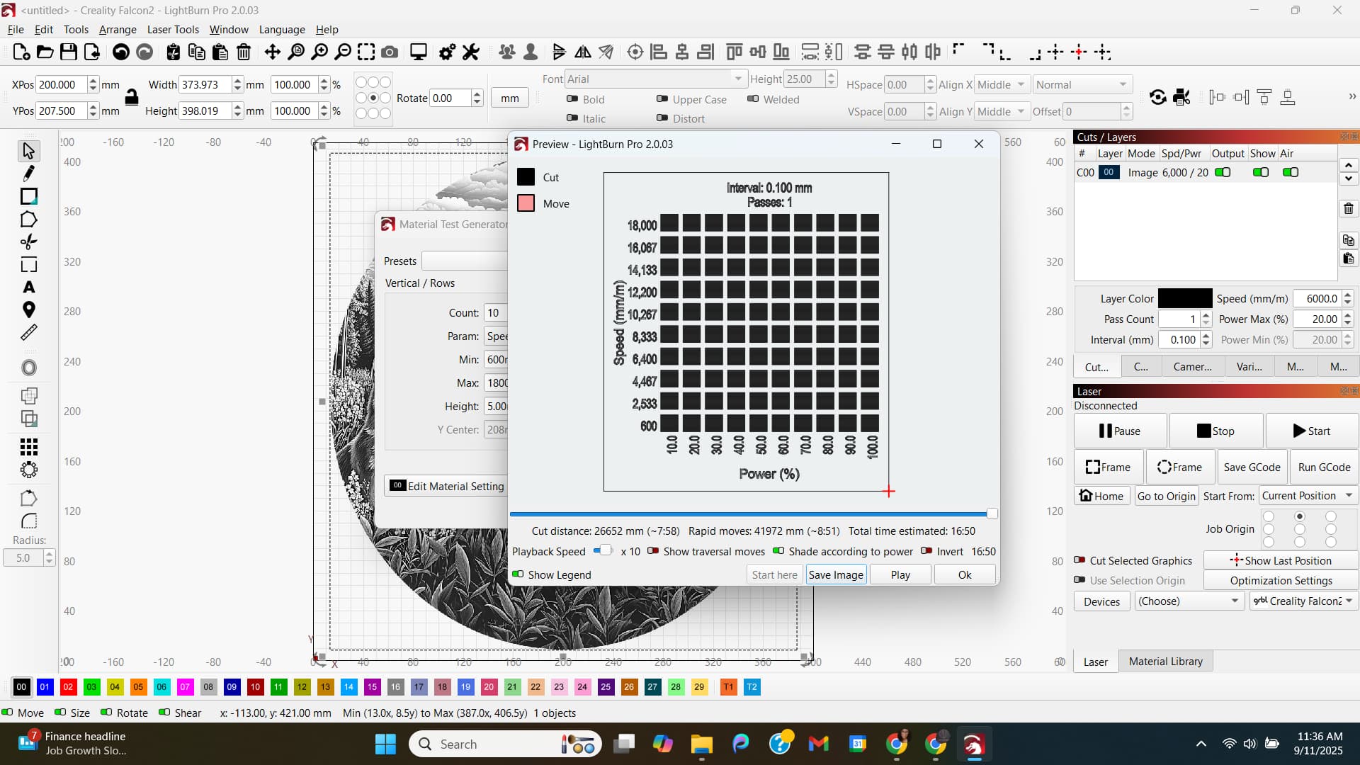

Running a materials test is also not running properly. It is showing the same box for every setting. When I did this previously it showed correctly, letting me see the different shades for the different settings so I could choose what would work best. Why would it be doing this suddenly (since update).

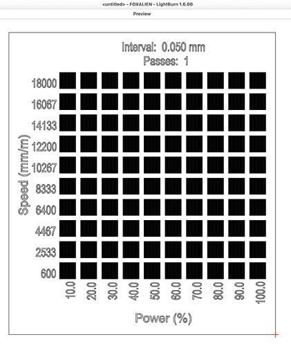

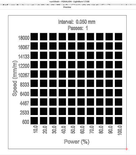

The material test looks the same in V1.6.00 and V1.7.08:
You are right. I went back to my previous photo. It was the finished product that showed the different colors. I am going to try to do one of those now. I was using 1.7.08
