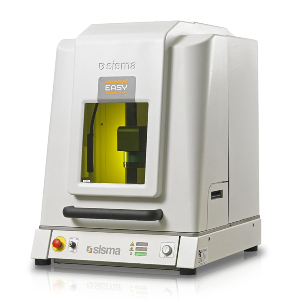

Newbie here.
I have a Sisma Easy200f, and have been running it for a few years with the supplied Prisma software.
Would like to use it with Lightburn, but the first hurdle is that the software is not recognising the laser?
What do I need to do?
Thanks in advance for your help
Fiber lasers have a galvo, laser source and a control board.
Lightburn has to be able to talk to your machines control board. It looks like it runs proprietary software, not EZCad2. If it ran EZCad2 it might work, but I’m suspicious you need to run their own software.
Maybe @Rick knows about them and can assist.
I don’t know anyone who has $43,313 to buy one of these. :face_with_spiral_eyes:
Good luck
I’m pretty certain this uses their own controller, and we will have no way to communicate with it via LightBurn at the moment.
Thanks for coming to my rescue. :face_with_spiral_eyes:
Sure looks like a nice machine… I was kind of surprised about it’s price tag.
