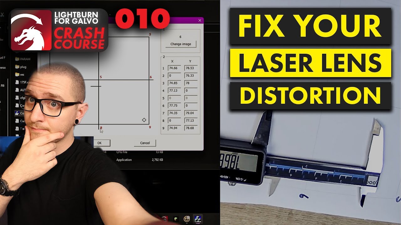

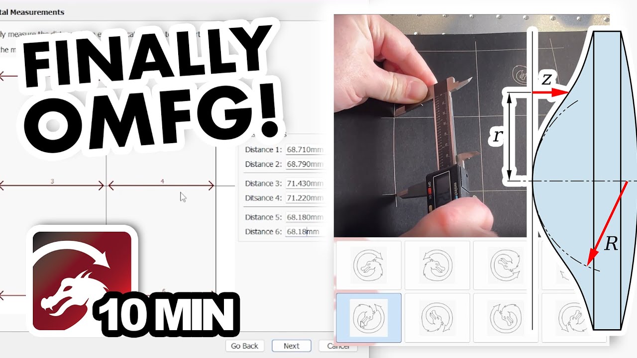

I don’t know how these markcfg7 files are created. I have no way that I know of to create them. I think that’s why they have the EZCad CoreFile2 software. When you get a new lens you need a correction configuration. You can do it manually or via software… I’d suggest software, it’s the least painful…
The new 1.50 version of the beta public release is out. I believe it has an entry in the Laser Tools → Lens Calibration
If not, you’d have to run the CoreFile2 software…
There are manual ways to do this, you can find them on You tube but I’m not doing that.
I still think your vendor should be responsible for handling this.
Good luck
Thank you so much for this information, I just downloaded the update for LightBurn and see this new option! I’ll be trying this out today. I’ll update this post if it resolves my issue to help anyone else that may have this problem as well.
BOOM! You nailed it, the video you sent me corrected ALL issues. Thank you so much! Image was stretched on the rotary because the lens needed corrections. Now when I make a box in lightburn at 2" it marks 2"
