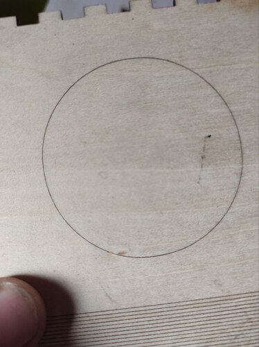

Hello, here is my issue :
I assembled a laser with 3d printed parts and with a lasertree module.
When in line mode or offset fill everything is working ok.
In scanning mode I have an alternating skew (see photos) .
It’s really visiblke when looking at the zero or the border of the gradient
Any ideas?
I tried with and without overscan, I tried checking my belts and pullies, everything is snug, i have no further ideas.
Thanks for your help !
Run a bi-directional fill on a rectangle and set line interval to something like 1 mm. If the results show different start and end positions for either direction then this is a scanning offset issue.
This can be either mechanical or electronic in nature.
If mechanical this is created by backlash in the system. Check everything but especially your X-axis pulley that it’s properly secured to the stepper motor. Create a circle design and run it. Do the ends of the circle meet perfectly? If so, then the problem is likely electronic.
You can use “Scanning offset adjustment” in Edit->Device Settings to address an electronic issue.
More information here:
Scanning Offset Adjustment - LightBurn Software Documentation
Thanks i’m gonna do that right now, then in will post the results here:
update :
As you can see in the pictures there is a difference in start and end postion as you predicted.
And the circle seem perfect.
I’m gonna try what you recommended in the documentation and i’ll update the post. Thanks !
