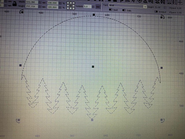

Good Morning! I am trying to alter this image and take away the top arc however it is attached to the trees… is there anyway to “slice” or “Cut” an image?
Christmas Scene
Node editing. Do a YouTube search for the phrase LightBurn Node Editing or search the forum or docs and you’ll find a lot of really helpful tutorials and instructions.
You can also point your cursor at this button image and press the F1 (help) key.
It’s worth mentioning that a decent number of the controls on the main window in LightBurn support this, so it’s a quick way to navigate the help. The next release will have of of this integrated into our new help docs, which are better for new users.
