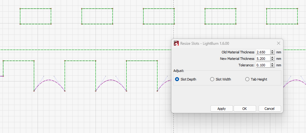

My slots and tabs resize aren’t working despite trying all the tips and tricks in the other forums.
-My nodes are simple and only the ones needed
-Everything is ungrouped
-I tried the optimize shapes to “Fit Shapes to Lines”
  • I tried breaking apart and joining back together
  • Tired offset shapes to “0”, set to corner and deleting original just in case there was an arc I’m missing
-I’m cutting with 5.2mm and it highlights like it is going to change, but doesn’t. What am I missing? I Also can’t upload anything. Everything is saying 0bytes. I’ve never had this issue. My file says 896KB

Here I show that I am seeing adjust when using the Slot Resizer tools.
Walk us through the process or steps you have taken, identifying where things do or do not go as you’d expect.

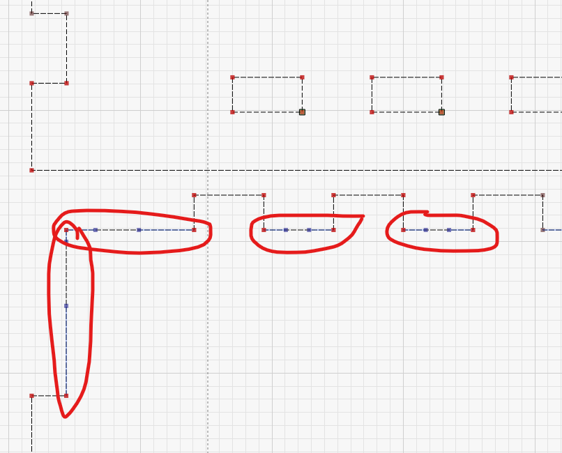

As far as I’ve tested it works for me (for most of it). However, something that needs addressing is some of the ‘lines’ are actually curves:
Which results in this:
Thanks Marcus! Nice catch. :slight_smile:
I did not inspect every slot and tab, which I should have. Thank you again for the detailed review.
I think it may be my computer at this point. I was finally able to get it to move, but only at a tolerance of 3+ which I thought was kind of odd. I’m just going to roll with it. I rarely mess with boxes, but I wanted to learn on my own in case I needed it. Thanks for your help!
Thanks Marcus. I did catch that and fixed it by optimizing shapes. I think it was my computer. Nothing was changing despite doing the same things over and over. I was able to get it to work after updating my computer AGAIN…and doing a hard reset. It still will only change at a tolerance of 3 or more, but at least I got that far. Thank you guys.
